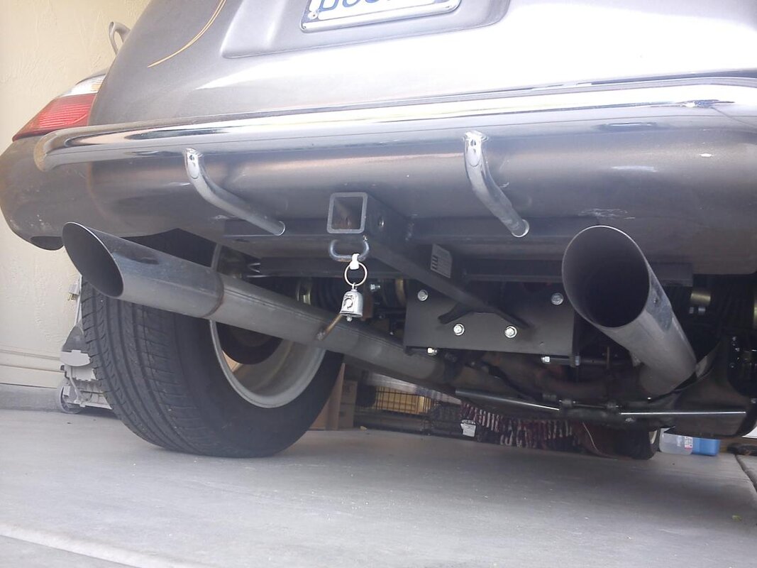

Here's what the local muffler shop did to mine......
Hey SMSgt I really like your exhaust and I happen to have a local muffler shop that is very reasonable and does excellent work like yours. The questions are; is this a Cat back exhaust? Or did you remove the cats first? And what did you do about mufflers? If not mufflers/cats, did it make a difference in the performance or lack there of, due to the light back pressure?
