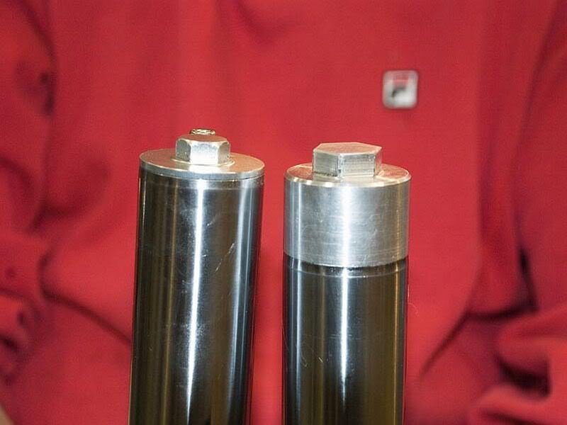

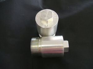

Hi Bazooka. Still nothing from motor trike. I am in fact completely in the dark concerning exactly what the fork extenders look like or where/ how they are fitted. Could you enlighten me on this?
Love this forum as you get so much back
Stock fork caps (left) vs fork extensions (right). They are machined from billet stainless steel and screw into the top of the forks, replacing the caps. (note: I got these photos off Google images. These extensions appear to be made of aluminum. Some companies do use aluminum for their extensions, mine are made from stainless)
Fork Extensions

Thank you Bazooka I really appreciated your help . M/T did get back to me and it seems the extenders were supplied and fitted . Now knowing what I am looking for I can confirm that they are fitted.
Motor trike are very good at answering enquiries and very helpful.
The photos proved useful in that I could identify the top of the fork with the machined nut .
