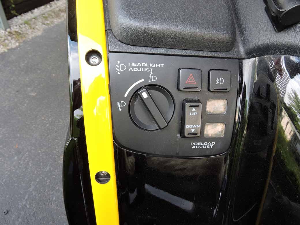

Instead of redesigning the air bag suspension, it might be easier to modify how the compressor is controlled. Can you post a picture of the control board you replaced last time?
This is the switch/control unit that was replaced.
When replaced everything continued working (or intermittently working) as it did prior to the replacement. So that at least eliminated the possibility of the switch itself being bad.
The replacement was easily done, everything was plug and play.
