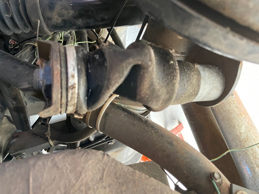

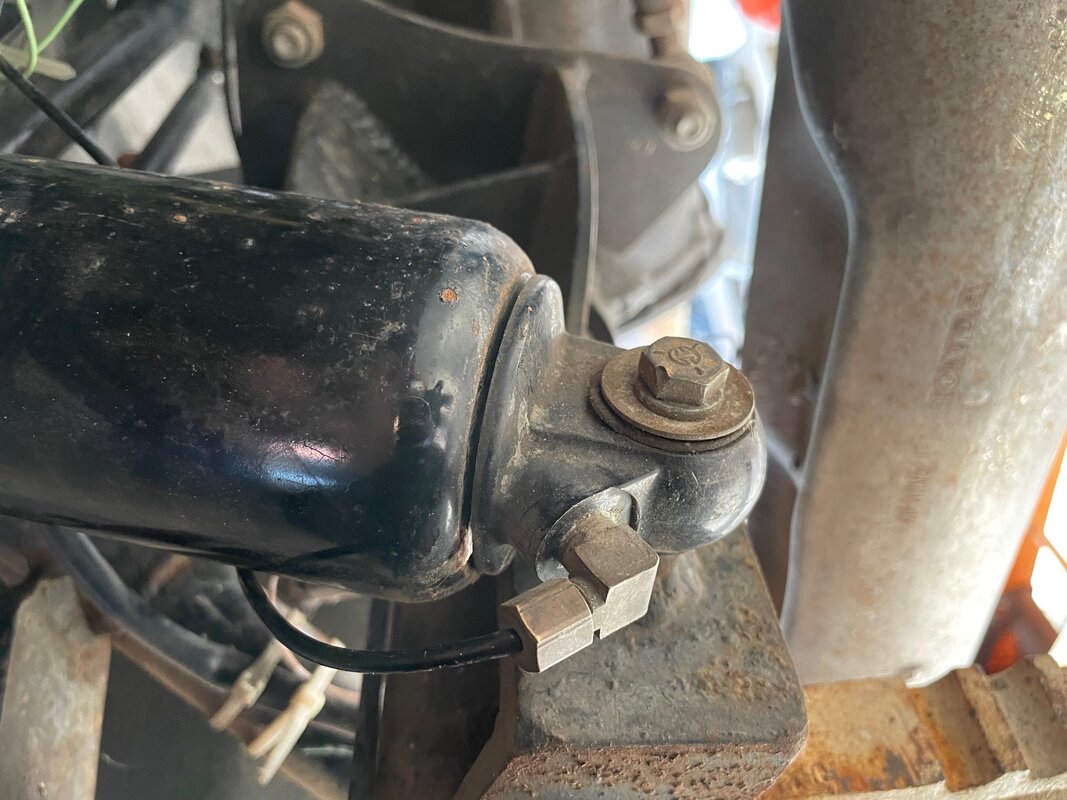

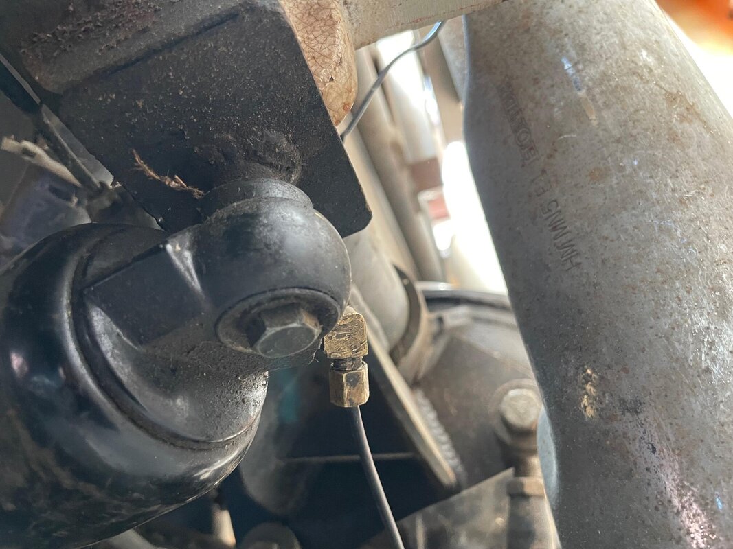

OK I am working on the air bags and shocks on this 1994 gl1500. The air bags do not have a air line going to them and completely collapsed. There is a air shock where my regular shocks are on my gl1800. The air lines are small which is not a problem but why does the air bags not have air lines. The hole is open with nothing in it. I am going to try to attach pictures. This is my third trike and all have been Motor Trike. IMG_0159.jpgIMG_0160.jpgIMG_0162.jpg
Best guess is someone decided it was easier/better to put air shocks on instead of messing with the bags.The question at this point is are they actually shocks or air cylinders
