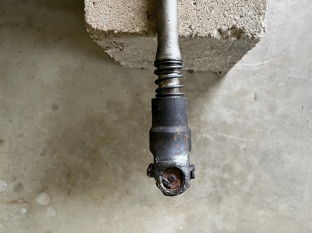

My dad has a 2006 Honda GL1800 with a California Side Car conversion. He bought it used and at this point I do not know what year it was converted. The u-joint on the front of the driveline failed and the driveline came apart. I am going to post pictures of what we removed. The front yolk that fits onto the splines of the engine side is MIA. Can anyone tell me where to track down a new driveline? Thank you all for the help!

I am not saying it will not but I haven't seen a way to get it off. It seems solid to me. There are splines on the shaft but I have no idea how the u joint yolk is held on the driveline but hasn't budged yet.
The front yoke looks like it hasn't seen any maintenance in a long time.

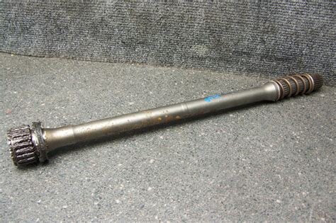

Is it just me or does that look like a drive shaft from a GL1500 Goldwing?drive.jpeg
To me it looks weird I have a 1500 at the shop now & a 05 1800 we just rebuilt the front end on today I will look Sunday to see what it looks like ?

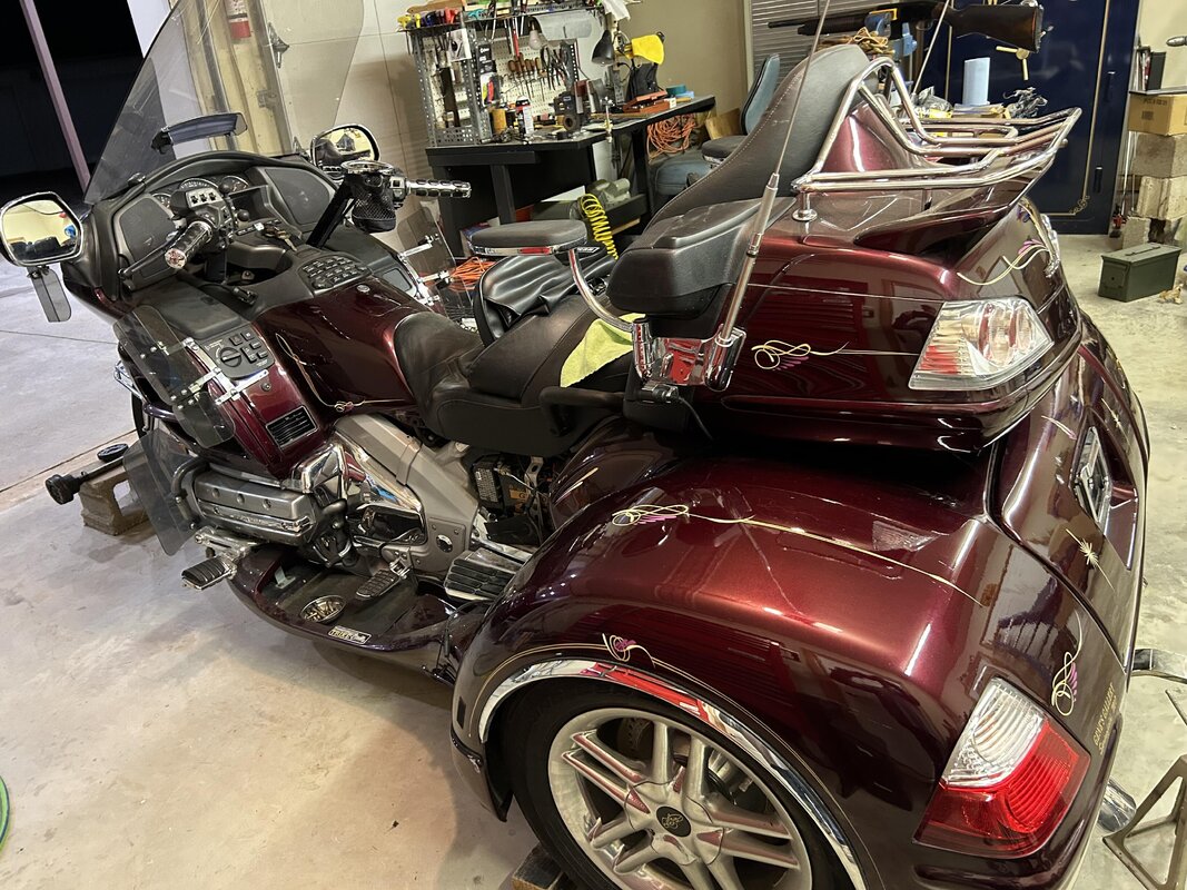

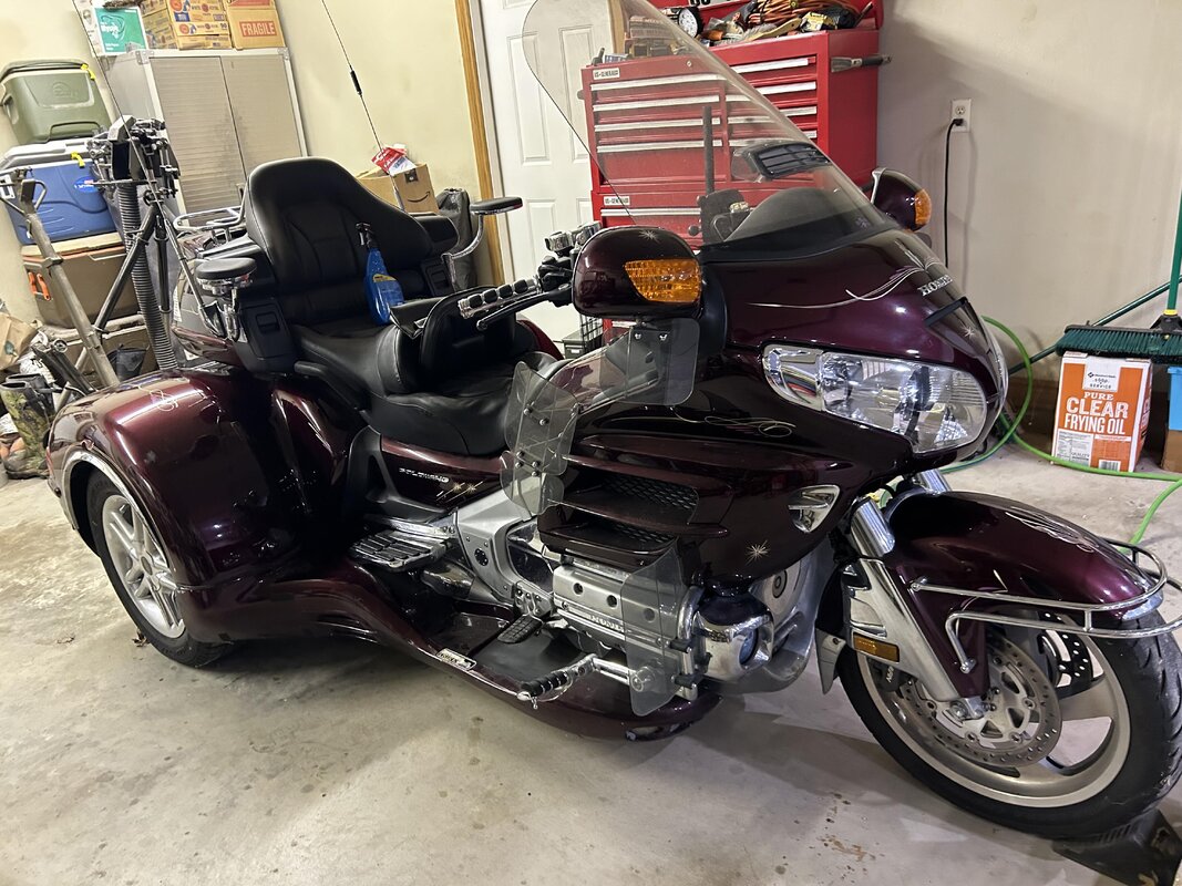

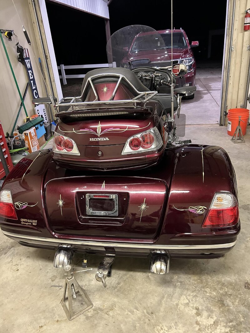

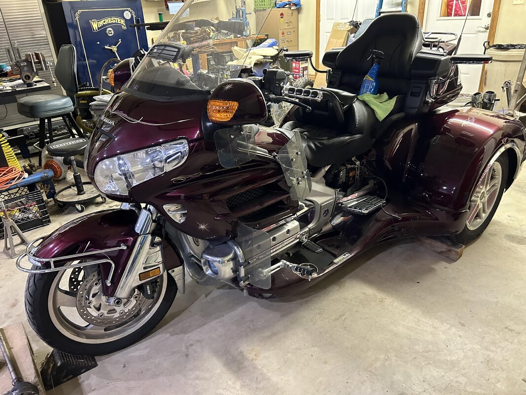

Post a picture of the trike
Can you post a pic of the trike? I pulled up the CSC installation manual for the GL1800 and something looks off.
I'm wondering if someone retrofit a 1500 kit to an 1800 or if its a home made construction with a CSC body.

I have not seen a driveshaft like that on a csc, I have two csc driveshafts they look nothing like that ?
If it is indeed a GL1500 drive shaft, it depends upon if the end piece is press fit and can be pressed out and a new one pressed in and the spring and u-joint for a GL1500 put in its place. Pictures of the underside of the trike would help us see what's there and maybe emailing the pic to CSC would shed light on what this is. I did find this document and it does mention an 'Inline Gear Box'

I still think it's the drive shaft from a two wheel Goldwing 1500 and those can be found at salvage yards and in trike shops.
If the shaft is still straight the easy thing if it can be matched to a 1500 or valkyrie front joint is replace that. The long term fix is the upgrade driveshaft but depending on how mechanically inclined and patient you are is intensive.

At least the last time I OH'd one of those, CSC still supported and sold parts for them, with the exception of the shaft. You'll need to clean and inspect the rear joint, and shaft splines. Sorry, I cannot remember the name for that rear joint style. It's kind of a half CV joint, but not. Here are my notes on the shaft. You'll need a new Delrin disc from CSC. If the shaft is still good, and the spring and front yoke is still available from Honda, you should be able for fix what you have. If not, CSC makes a drive shaft upgrade that requires lots of labor to install. To install it, I beleive the rear body has to be lifted.
2006 GL1800 CSC INDEPENDENT SUSPENSION INFO ON DRIVE SHAFT
- frt yoke is from a GL1500
- Honda part 40200-MZ0-A00
- spring is Honda 40215-MN5-000
- rear CV joint is EMPI VW-201 1 1145
GREASE FOR JOINT IS RED
GREASE FOR FRONT SHAFT SPLINES AND OUTPUT SHAFT IS:
- moly 57
- moly 60
- MolyKote
