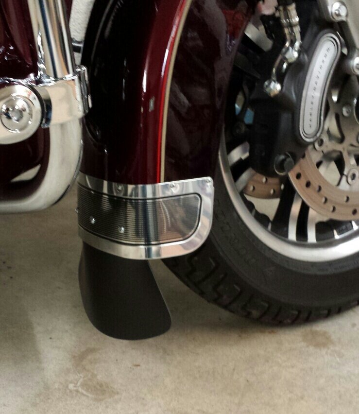

FWIW, I just ordered a mud flap for the front fender of the trike. Hopefully the mud flap will sit close enough to the ground to stop any stones being thrown hard enough that they could bounce high enough to get near the belt. I'll have to take another look to see if a second mud flap in front of the belt might be a better idea.

I'm also looking to install a mud flap on the front of my Trike, what did you purchase and where did you find it?
I wish I could remember! When it gets here I try to remember to post where I got it from and a pic. It's the Old Fart's Disease, ya know.

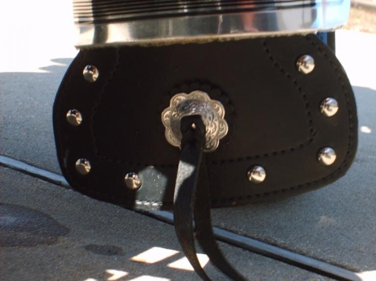

Here is one I had made by one of the site sponsers Cap't Itch. It's leather and does an excellent job and I never noticed any difference on oil temps after the install. I've got over 15K on this mud flap now and have no intention of doing without.
