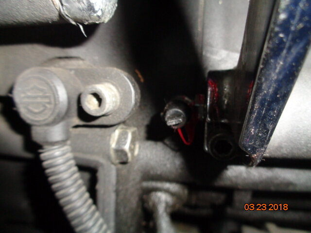

Here is your shifter linkage can you pick out what part is getting replaced?

I'm told this is very common... in fact, I see several companies make an aftermarket shaft and lever. ( Baker... Pingel etc) The spline strips out easily and you find yourself stuck in whatever gear you happen to be in at the time. My dealer tells me to carry a replacement with me on the road.
They redesigned the shifter for the M8 in 2017, knowing it was problematic.
I have seen YouTube videos on it being a problem & to keep an eye on it for tightness.
UPDATE: Here is a HD tech, John Maxwell, covering your T/C shifter problems at about minute 3:45 of this video. Very good information on how to fix a common problem.

I had to have part 31 replaced on my Freewheeler while I was out of town. The service tech told me that would not have happened had my dealer checked the shifter during the service which was done less than 1,000 miles prior. I now take it to another dealer and I do check the shifter frequently.
They have been known to fall off after the pinch bolt falls off

I repaired a bunch of those type shifter levers on ATC's And once on my 11 Tri-Glide...
I would replace the bolt with a new one, Then file the opening in clamp part to make the slit wider then the clamp will tighten more on the shaft...The lever is made of softer medal [AKA sacrificial medal] than the harden spine shaft......If the lever gets too lose the harden shaft will eat the clamping part up, Better than if the lever was harden and then eat the shaft ....And then the tranny has to be opened up..

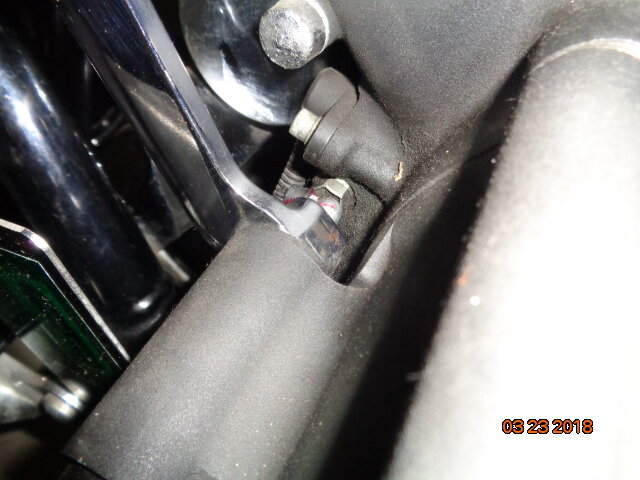

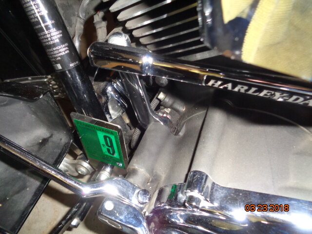

There doesn't appear to be any way to lube #31 without pulling bolt #1, yank out the shift levers #13 and buttering some white lithium
on the shaft....would be a jim dandy spot to drill/tap in a zerk fitting, yes?
Lola, did you happen to notice if there were o-rings on either end of where the shaft fits inside the casting?
I drill and tap the primary where the shaft runs thru, I grease it each oil change

Another note, if your shifter rattles you can shim the shaft with wave washers;)

The part the service tech showed me was metal only.
