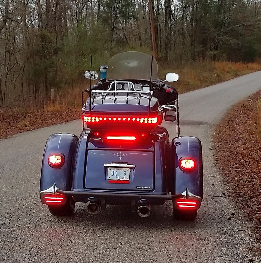

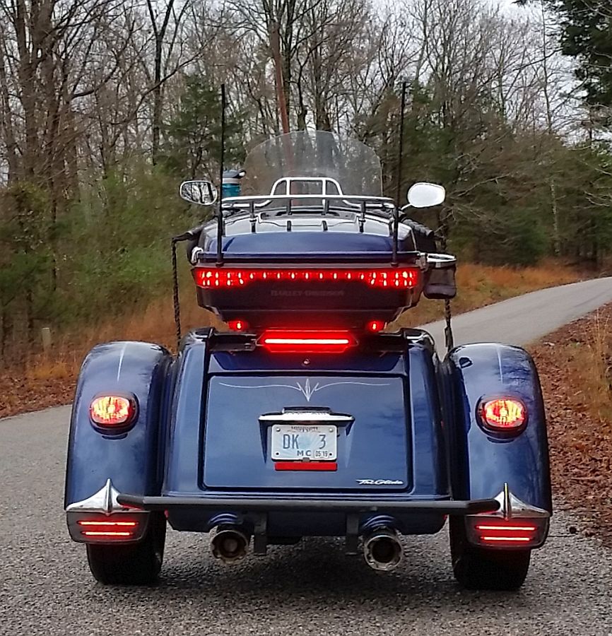

Rode into work this morning and stopped along the side of the road to get some photo's of the best rear light set up available (yeah, I'm biased, but look at it! ;) )
Brakes on-
Brakes off-
Brakes on...this is where you really want to get their attention-
The lights in the LED Tour-Pak Filler are Run-Brake & Turn...and they are BRIGHT. They get the job done.
The Mud Flap LED set up is also Run-Brake & Turn, and they are attention getters too...icing on the cake.
If you're serious about being seen, there is nothing that can go into the stock fender lights that will match up against these lights....day or night.
