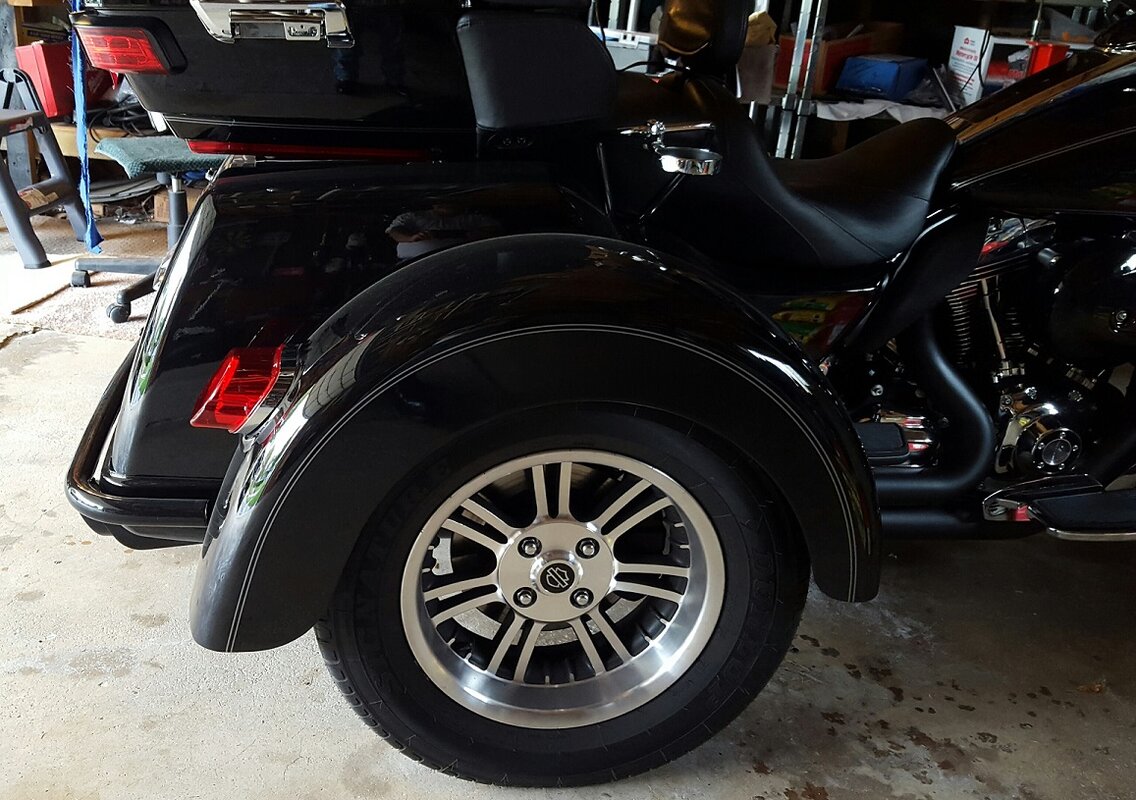

So I've been looking around for just the right lights for my 2012 Triglide. Reading this thread, I decided to order the Radiantz 9903-18, lay-down, red lens, strobe. Two problems with these lights. One is the connectors do not snap into place in the Harley female connector on the bike. There is nothing to hold them in. I know what your saying, "It's either the installer or the foam gasket will hold the connector in." Directly behind the connector in the light/lens assembly is a large cavity. The foam gasket never touches the back of the connector. Radiantz folks on the phone were great, however I got the usual "It's never happened before." This is generally the reply companies offer when what they really want to say is, "You are a cusomter and therefore you know nothing." The second problem is that once installed the turn signals went batpoop crazy. Another call to Radiantz and another $80 later they're sending a plug and play load equalizer. Now I'm into LED tail lights at the cost of the MOCO units that I'm sure would plug and play.
Yeah.....I think we could have been a bit more specific. Needing a Load Equalizer on the older models {even pre-2014} is 99%. That was part of my question on being plug and play. I've used LED lighting on previous Harleys and always needed the Equalizer. As they have changed the System in 2014 I was trying to make sure it was in fact plug and play. As for the plug...it is the foam on the existing lens that holds the plug in place.
I'm also thinking you would need the Equalizer with the Moco units. And at least you will be getting the laydown and Flash function.

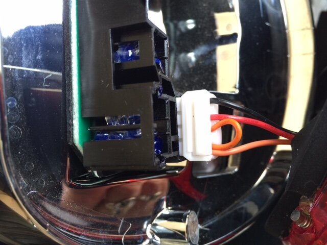

The foam does not hold the plug in place. There is a plastic spring molded into the connector that snaps shut when it is inserted into the female receptacle on the bike just as does every other such connector on the bike and every auto bring manufactured today. On the Radiantz lights, the foam stops way short of that location and there is a large open area going back to the lens that the connector can fall into. I think Radiantz doesn't want to admit they got a bad batch of connectors and they offered no solution. Harley service tech and parts manager assures me the Harley lights are $5 more than the Radiantz plus the cost of the equalizer, but do not require a load equalizer.

Well - Not on mine is all I can say. My 2013 needed a Load Equalizer, but not a FLH.

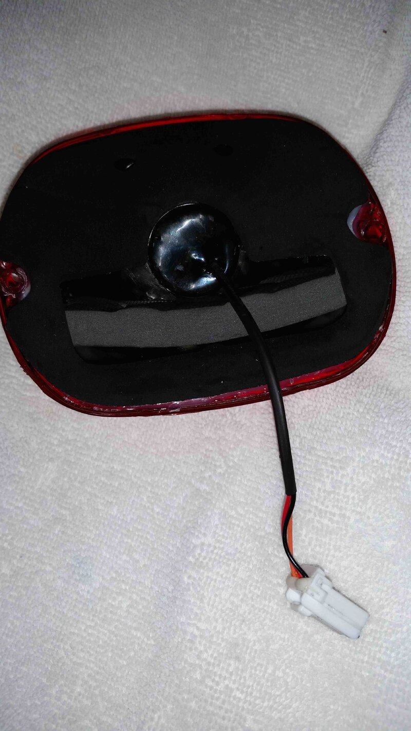

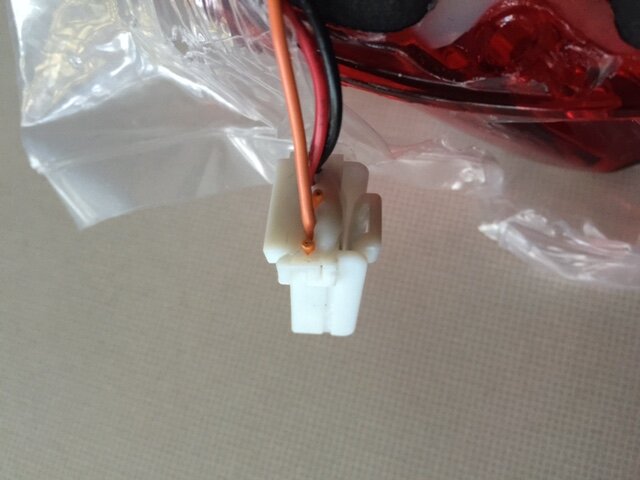

Acouple of pictures of my lite problem. Radiantz LED lites, the plug with the little loop in the plug, snaps right in. The plug on the left thats looks like it has some weird plastic blob on it, loop has been cut off, would not seat all of the way. I looked at the pin side and it looks as tho some of that plastic stuff got inside of the female pin. Now both lights came from a different dealer. In other words I was trying save a buck. Both off of Amazon. The one with the bad plug I just sent back today to Radiantz with a note stating what the problem was. Amazon has refunded my money so I have another on the way from Cycle shack. Hope it comes with a good plug on it.

Radiantz is reluctant to admit anything might be wrong with their connectors. Glad to see I'm not alone on this issue. Some folks' connectors click into place just like the OEMs, and some don't.

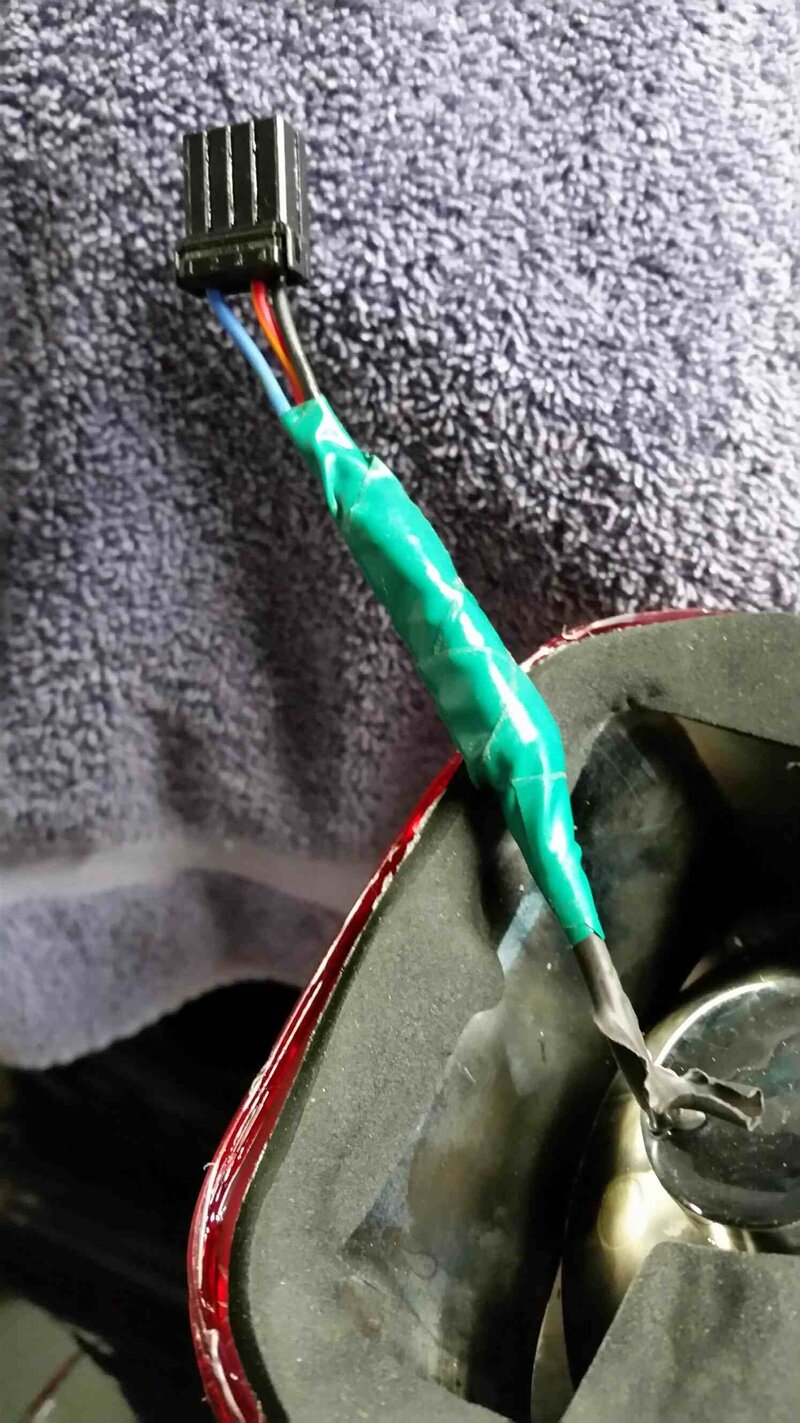

Problem Solved
Spliced OEM plug into new LED light. Snapped in like it should.

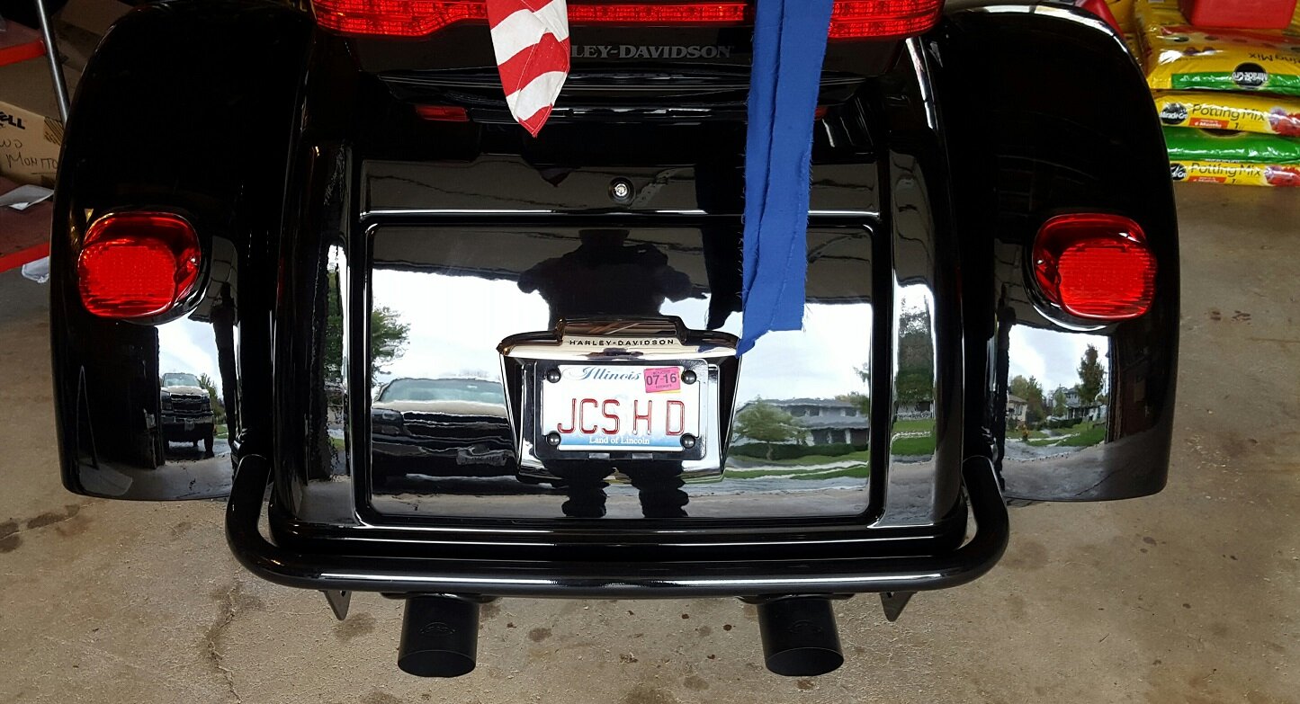

After looking at the Video of the manic flashing of both the Tail lights with the strobe option, I decided to just go with the straight LED Red Laydown option. $180 total cost and really like them. The Laydown looks better {IMO} and the difference in brightness is large! Took about 10 minutes - Turned the bike on - Hit the flashers for about 10 blinks and all works as intended. Very glad I went with the unit as opposed to LED Bulbs only. The Laydown. the Brightness and matching the lights to the Tourpak worked out good for me. Thanks
View attachment 31064View attachment 31065
