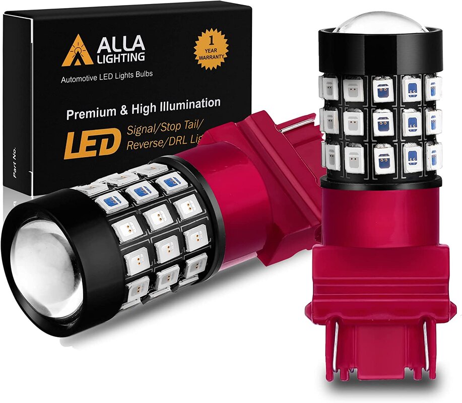

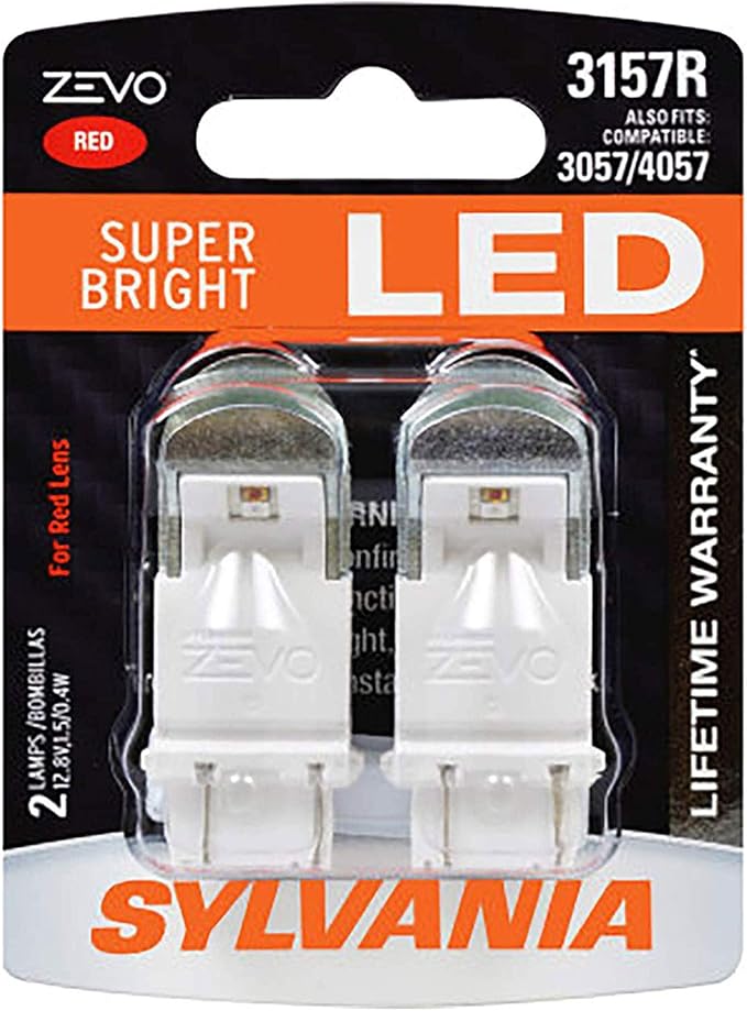

The stock bulb is a 3157 K. this is pretty much the same as a 3157 bulb, but a few lumen s brighter, therefore the Sylvania 3157R bulbs will work
The 3157K bulb has been used for a number of years on HD trikes now
I have replaced 3 sets of these on 17-21 models already with no problems
Get a set of these, they have flasher built in, flash 3 times then steady. Note, some of the LED bulbs are directional (diode) so if they do not light, try reversing the bulb in the socket.
I have these on my 2019 Trike and they work just fine.
https://www.amazon.com/gp/product/B07F9JXWT2/ref=ppx_yo_dt_b_search_asin_title?ie=UTF8&psc=1
I went to Amazon to order these and their website says it does not fit my 2021 Tri Glide. If the 3157 is a replacement for the stock then I would think these would work. May just get the ones at AutoZone but would really like the ALLA. Can someone please verify that the ALLA really do fit the 2021 Tri Glide.
if they are ones in Kool Breeze's post; they worked just fine on my 21 TG. They were plug and play on my bike.

Sylvania like others have not updated their web sites for 21 and newer models
These bulbs all will work on these models, tho you may still have to run your 4 ways for a minute or two for the canbus system BCM to recognise the change

I switched my 2020 Freewheeler from the stock bulbs to the Sylvania "super bright" leds. It was a bit of an improvement.
Then I went to the Eagle units. Night and day difference.
Received these in the mail this morn. I put them in and yes indeed, they do fit perfectly. I love the way they flash when hitting the brakes, kinda have a strange flash for turn signals though. THEN, I turned up the volume on my radio. So much static it made the music hard to understand. Yea, serious static, and got much worse with turn signals applied, or brakes. They would work great for anyone not desiring to use the radio, for me, they came out and stock bulbs went back in. Don't know what I'm going to do with the ALLA bulbs but I can say they will not be going back on my '21 trike.
Unfortunately this is a common issue with the "cheaper" LEDs. They produce a lot more noise due to weak EMI suppression. That's why I went with all Custom Dynamics in mine. If I had've went cheaper, with as many as I have added, I probably wouldn't be able to use my phone either. I just watched for sales or built up points at JP to get all of mine or used Harley gift cards I have been given. Sometimes it really is buy once, cry once.
Thanks for the response. Looks like I will probably check out the Custom Dynamics ones. I do have their front turn signal LED inserts and they work fine.

I've been reading the posts from the present and past on led bulbs and the complete units. Well I weighed out the costs of the bulbs vs complete tail light and decided to go with the bulbs. Amazon and Ebay have an unbelievable selection from 10 bucks to 30 bucks. The ones that impressed me the most was the ones that "Koolbreeze" purchased from Amazon. They are "Alla" brand bulbs. I'm glad that I decided on those because they are great! They are very bright compared to the stock bulbs. Didn't have to do anything but take out stock ones and put the new ones in. Anyone on the fence you won't be sorry. It will be a couple months before I can ride (live in Western Maryland) so far so good.
