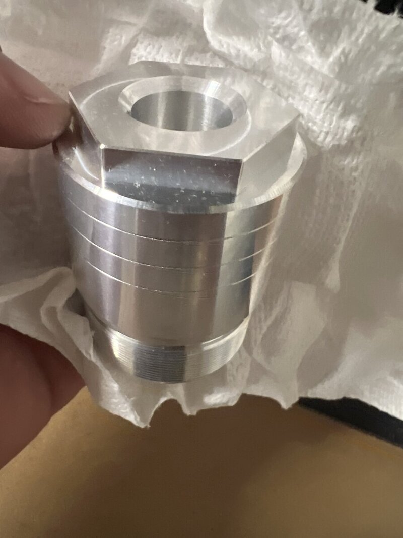

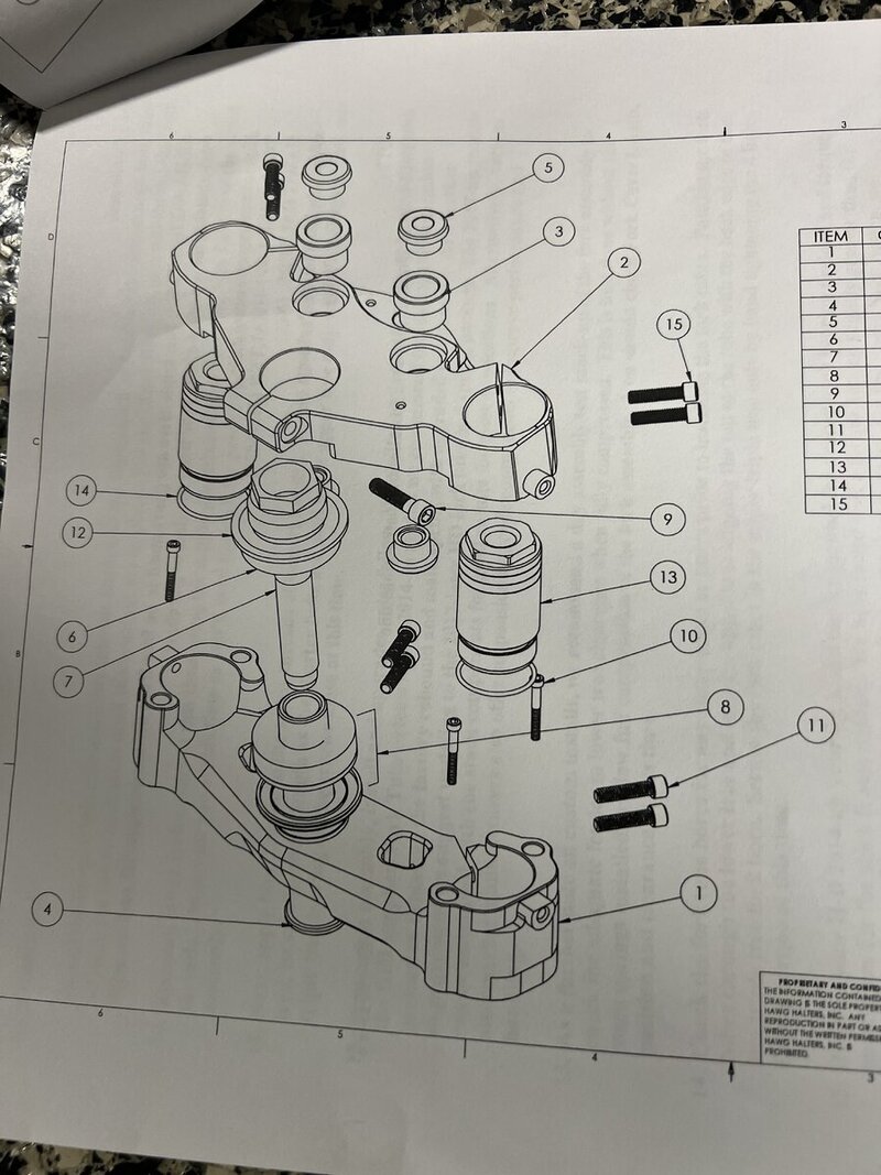

Negative….. it all comes complete with everything you need including the fork extensions. In fact you will also benefit a better front ride if you have a fork kit already in too.
Pics of the fork extensions:
You don't need to change anything, unless you are not happy with your front suspension. Most do not, but Brett being Brett probably has.👍
Yes sir! Lol! Ya definitely know me!
I already had a ProAction fork kit installed prior over last winter…
But it’s definitely more noticeable now with the rake kit and the front is MUCH smoother. 👍🏻
If you do some research on here I did a report on this for Randy probably 8 years ago when I installed one on the 2013 TG.
I put well over 60k miles on the trike with the rake kit and it is definitely an outstanding mod, and with the rake the steering is SO MUCH better.
If you do your own work it's a half to full day job. Not difficult for the average wrench turner.

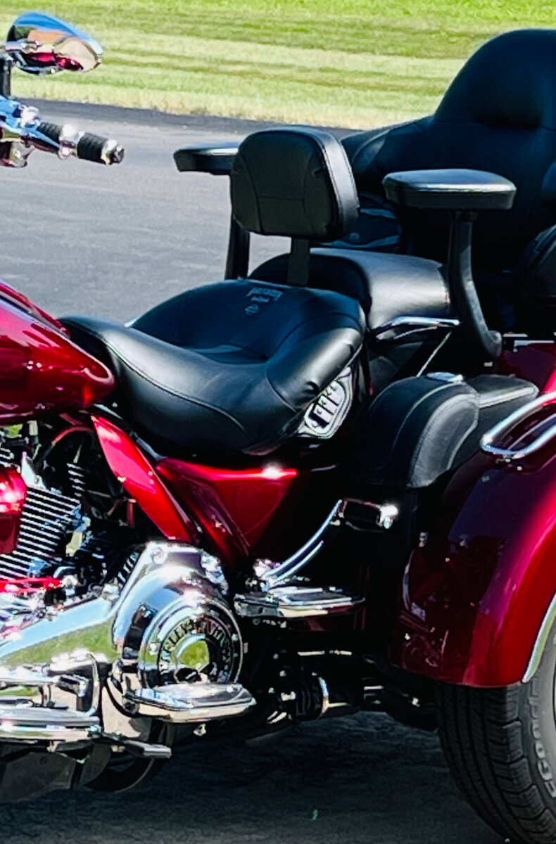

Could you please tell me the type of rider and passenger seat that you have installed in this video? It looks like the passenger seat is taller than most. My wife complains about harley tallboy seat height. Of course it doesn't help that I am 6'6" and hard to see over or around. Thanks in advance!
I can say there is NO change in any type of buffeting whatsoever. I actually changed out my KlockWerks in favor of a Freedom Shields just not too long ago and already loved the new windshield and can say it is unchanged, so no worries there.
The seat came with the trike when I bought it. It is the Harley Davidson Road Zeppelin (Air adjustable) seat. It’s an awesome & extremely comfortable seat & it’s also rider seat & lumbar & Passenger seat all air adjustable.

Thanks for the offer. I'm pretty sure I can get it done. I have removed inner fairings and front shocks a number of times. Never removed or installed a triple tree, but it doesn't look that hard. I'm sure that I will have a call or two with Papa Zook if I get stuck. I went to high school at Quigley in Baden (no longer there). We used Freedom's football field as our home field since we didn't have one.
