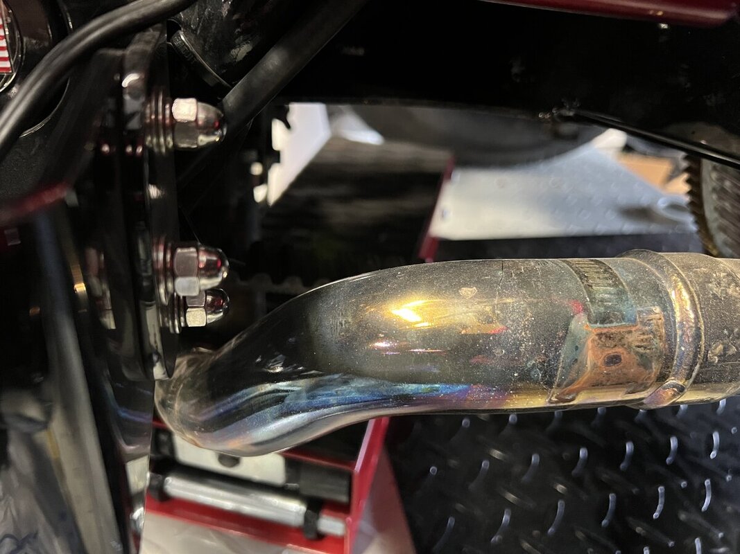

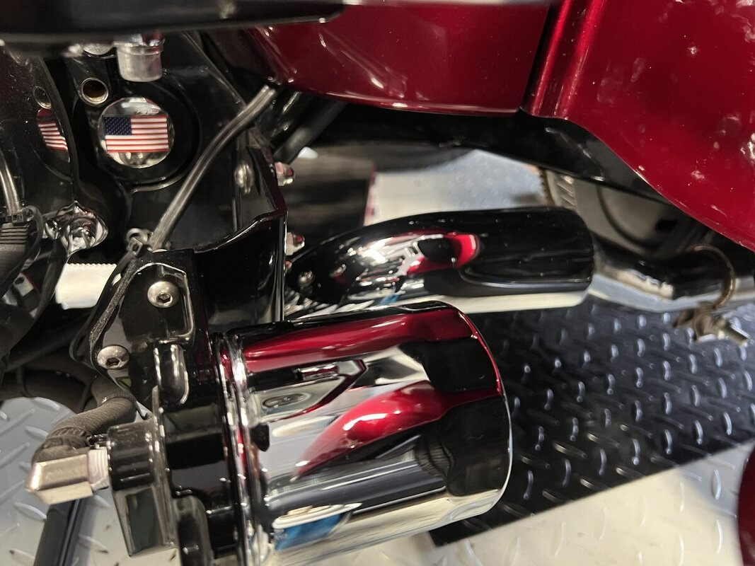

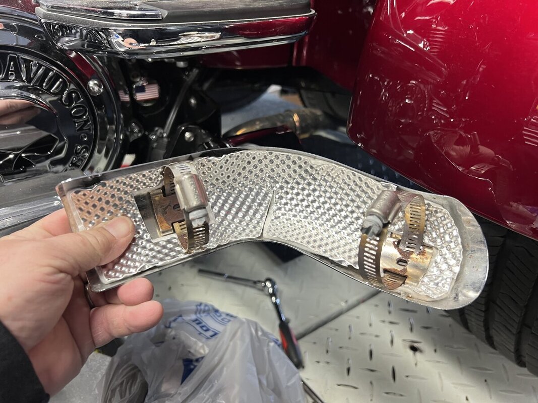

I forgot to add this info: …….
The video I did only shows the main three pieces on the RH side (both headers & the Cat area)… but the kit does indeed include a smaller forth piece (which goes under the belt and turns out back on the LH side).
so it is a 4 piece kit.
Here’s pics of the fourth piece, before & after:
Again, a very nice kit, reasonably priced, and not even visable!
