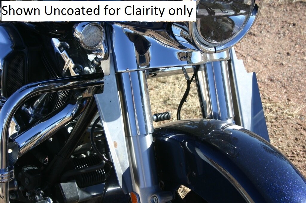

jes custom fork lowers
Those do a great job of blocking the buffeting air to the rider, they also block a lot of air to the engine.
Typically the engine temps will be around 20* higher with them installed, while rolling down the road.
