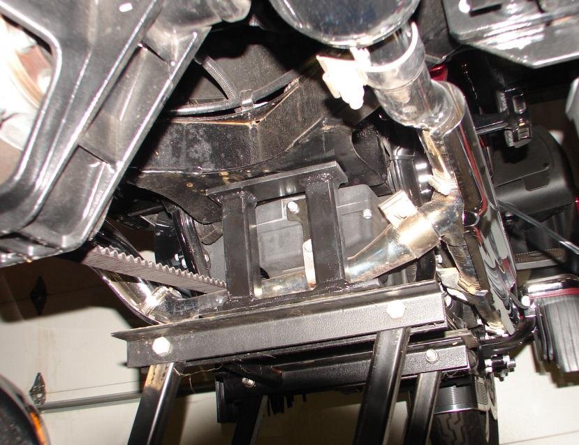

I use a J&S trike jack .... but adapters can be found for regular cycle jacks. Here is a picture of a Pitbull adapter showing where it goes.
The J&S trike jack has this feature built in. A J&S trike jack can also be fitted with an adapter rail making it work with regular cycles.

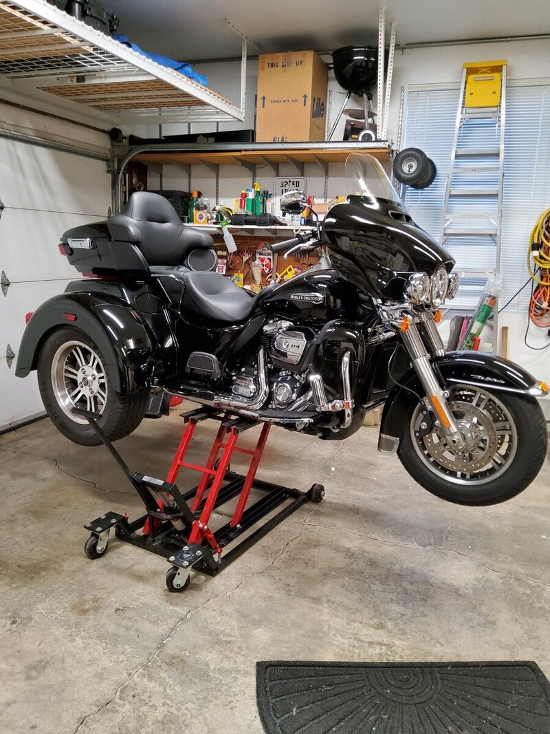

Nice picture I took...:D Of me lifting the TRIGLIDE
