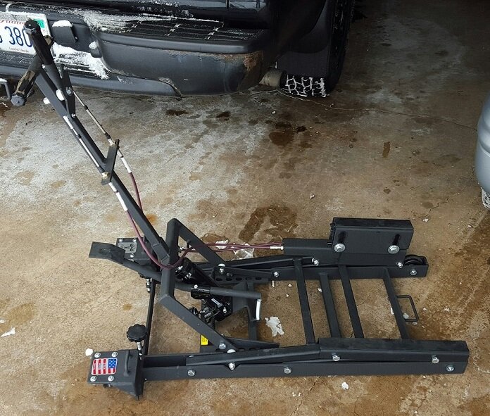

If you are planning on other projects I would suggest a Lift from J&S......I really like mine!

I also am very glad I purchased a J&S trike jack. :D
