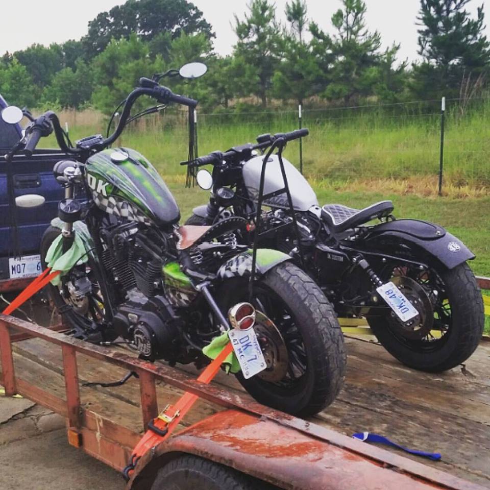

We tow in our Toy Hauler quite a bit these days. Video on loading it below...essentially the same process as on a utility trailer.
We have towed a few bikes to a couple of events over the years. Here's a pic of one time going to Little Sturgis. Mary pulled both the Sportys and I rode the third bike.
