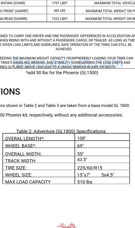

Looking at the specs, it's showing a width of 55" so you would be good there. But it also shows an overall length of 108" and trailer is only 105". With a fold up ramp in rear, I don't think it's going to work. If the ramp is removable, it could possibly be an option. But if ramp permanently attached, it's going to be an issue...
