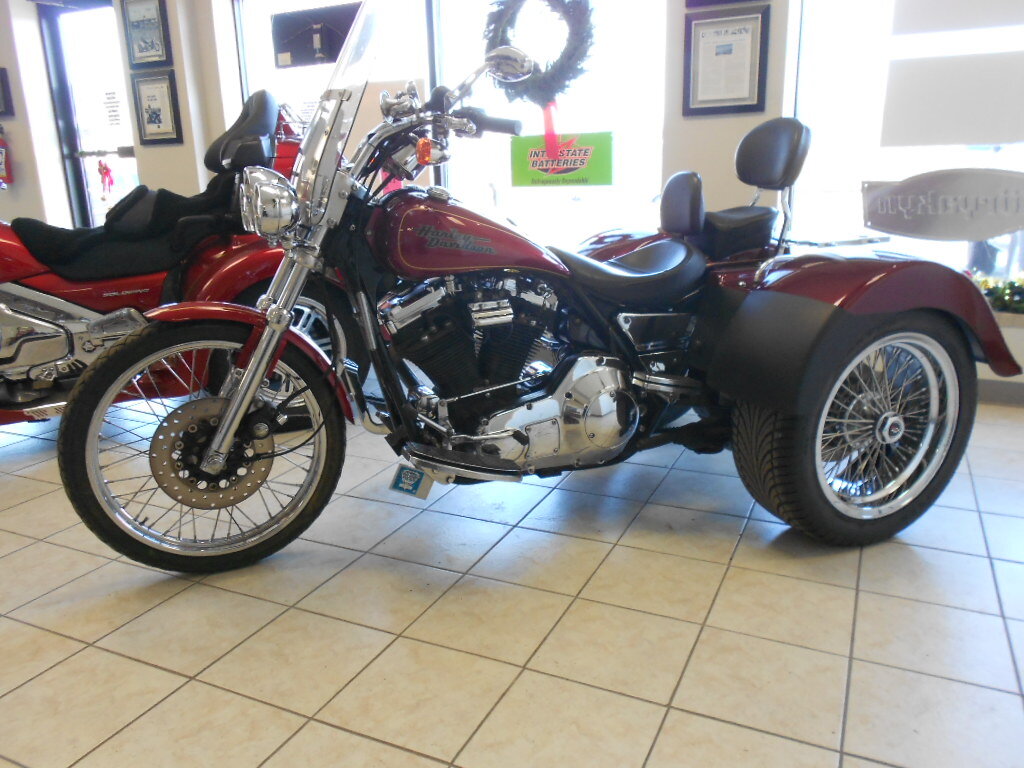

Need info on a 2000 Lehman bandit kit, break shoes and drums with 14" wheels.
It's on my 2003 Harley Davidson sportster! What brand or kind is it?
Dan, Those brakes probably only need adjustment and usually last 60-80,000 miles. They need adjustment every 5-10,000 miles depending on your riding style and demands. The brake shoes were readily available for 30 years but are now special order locally. The same with the drums. I stock both if needed.
