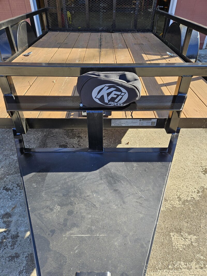

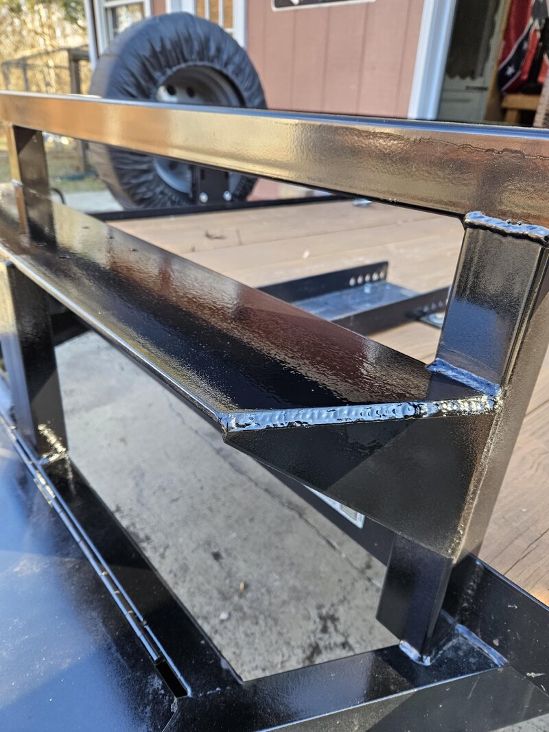

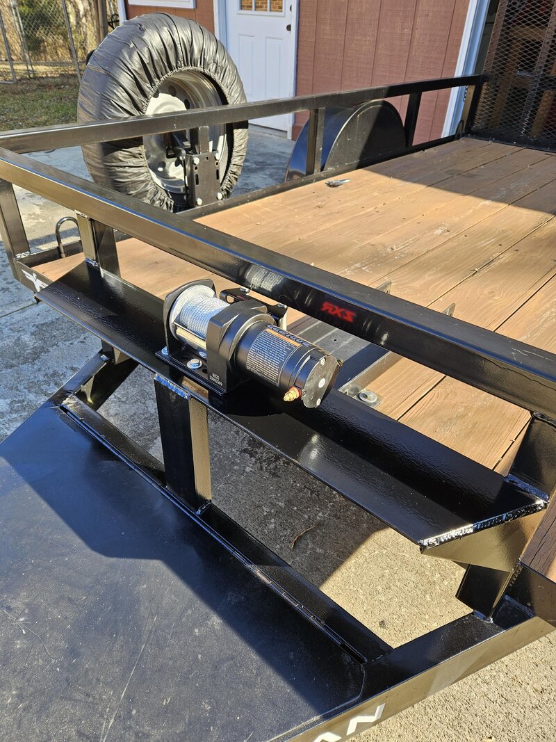

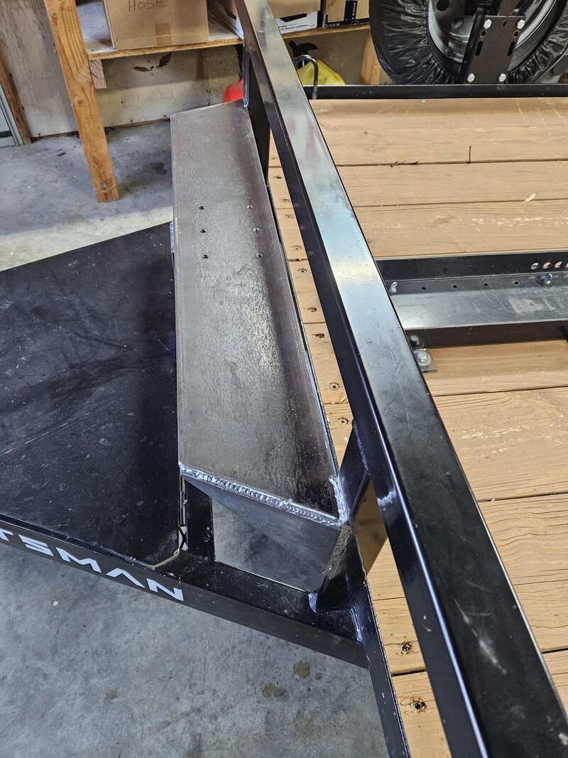

In November I asked about winching a TG onto a trailer. I finally got around to installing one on my Karftsman 6.5x10 trailer. The project came out pretty well.
