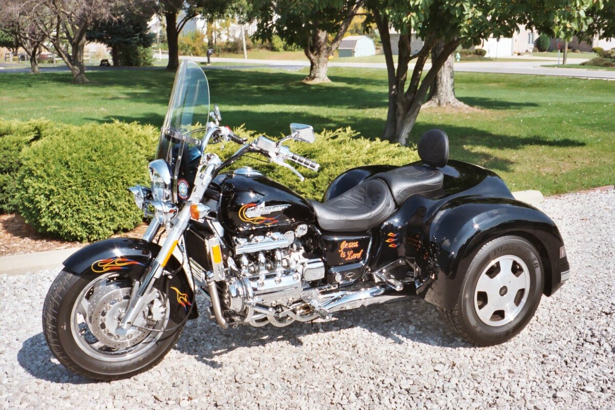

Last year I replaced both rear tires with Cooper Trendsetter SE Tires (205/70R/14)
from Tire Central & Service. This is a quiet-running tire with excellent
traction. In my opinion no other tire at this price offers the level of performance and durability as these tires.
14" tires with a Valkyrie?? With the gearing and power that my 99 Valk had. Id shred a 14 inch tire. Why so small a rear tire?? Just curious.
I just looked at the tires you have. They do come in my size. But they have an A rating for tread and a B for temps. Which by itself doesn't really mean much. I will look into seeing if they are available locally and at what price. Cant be too high priced as an entry level tire.
