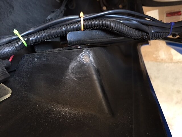

Here's a new one. I opened the hood today to discover a spot that had some of the gel coat rubbed off. It is rubbing on the radiator fluid reservoir. I'm happy I caught it because it was starting to damage the reservoir. Is there a way to adjust the hood farther forward? It hasn't been doing this before I discovered it today. I didn't notice it a week ago when I changed the oil. I did ride it about 175 miles yesterday. Thx Rick
I don't know what happened. The hood still seems to be aligned properly. I should say it's the fiberglass, not the gel coat, since it's inside the engine compartment.

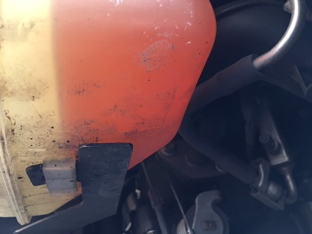

Here's some pictures of what's rubbing. You can see the spot I think it's rubbing on the coolant tank.

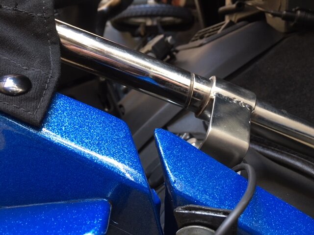

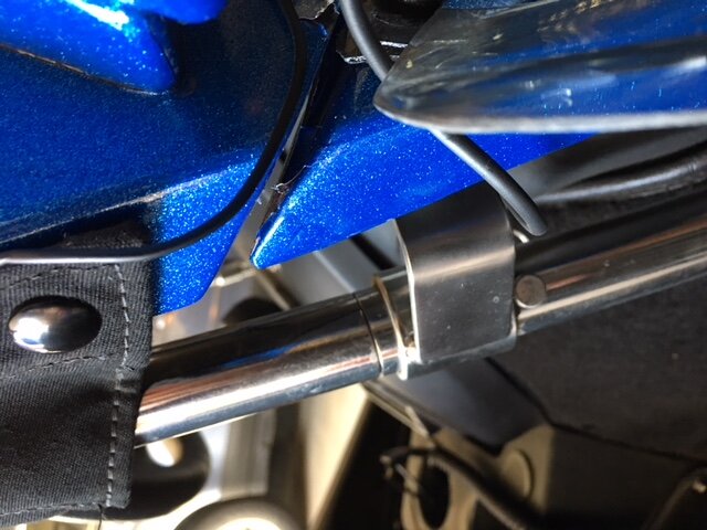

Tom, As you can see by the first two pictures, the hood seems to be in good alignment with the body. I'm confused as to what's going on. Rick

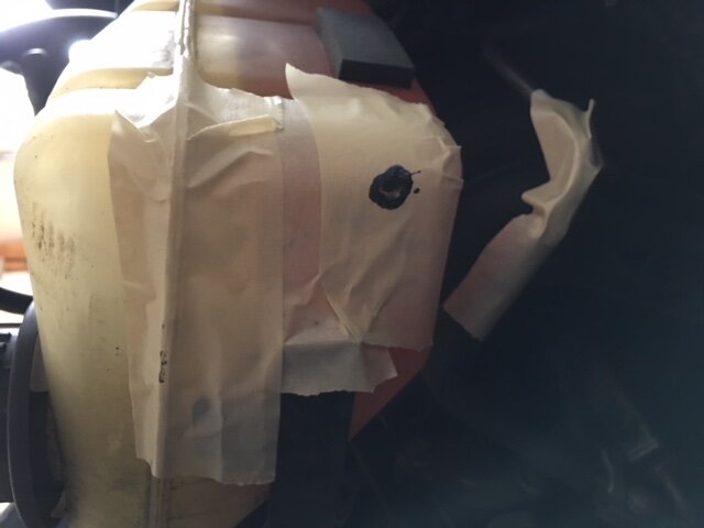

I looked at MJ's Stallion and the spot that is rubbing on your fiberglass is most likely the front coolant tank bracket. Looking at your picture of the front bracket I see what appears to me to be a spot right on the corner where the black paint is worn off. On MJ's Stallion that spot matches exactly where the fiberglass is being rubbed off. I pushed on the bracket on her trike and there is a little movement but not much at all. Like Richard said I would look seriously at your coolant tank being a little loose.

Thanks Ted. I did push on the inner hood and it seemed tight. The bracket is also tight. I'll put some tape on the bracket and close the hood a few times and see if that's the culprit. Rick
If all is tight then maybe just a hard push back on the coolant tank will provide the necessary clearance again.

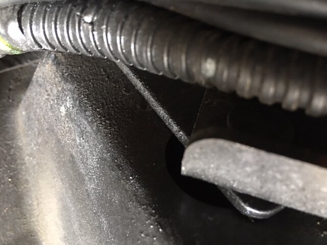

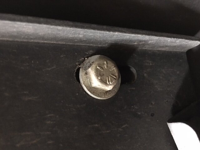

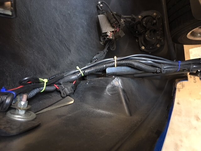

Got home and after I thought about it, there is an easy way to find out where it's rubbing. I put some tape on the coolant tank, sprayed some paint on the rubbing part of the hood and it's really obvious where it's rubbing. Both brackets on the tank are tight and solid. As you can see by the pictures, the hood mounting bracket screws don't seem like they moved and they were tight. Does anyone have suggestions on how this could have happened and how to fix it? Thx Rick

Been looking at your pictures & information as time allowed (yesterday was a bit nuts). I missed it previously, but noticed this morning you mentioned you made a small adjustment because the hood was close near the mirrors. I don't know if the rub is old or fairly new, but could it happen to be a result of that?
You may try posting a picture from a bit further back showing the coolant tank that shows the surrounding components, etc. They may indicate something that the close up pictures don't.
Thanks Richard. I didn't do any adjustments. Must of been someone else you're thinking about the mirrors. The only thing I did the week before I noticed this was change the oil. I drove the front wheel up on a ramp to do it. Went up very slow and came back down very slow. I usually look around pretty well and make sure nothing is loose or leaking. I did not notice the rubbing at that time. I did see it the next week. It couldn't have been rubbing very long or it would have rubbed a hole in the coolant tank as it has a spot worn on it from the little mileage I put on it last Saturday. It's under the tape where the black mark is.
I did take some close pictures of the hood to show that it still seems like it's aligned by the mirrors and the mounting bolts inside on the hinges don't look like the moved.
