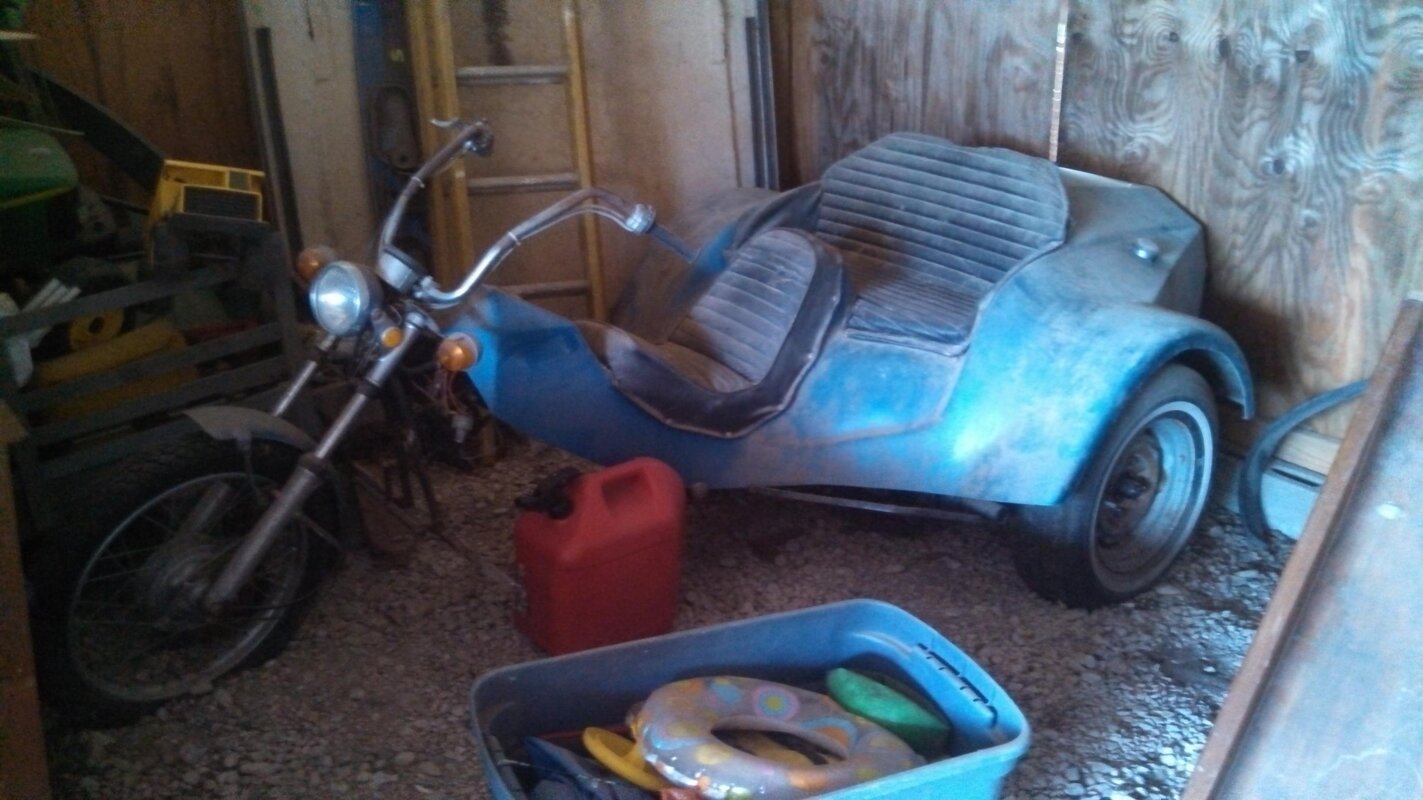

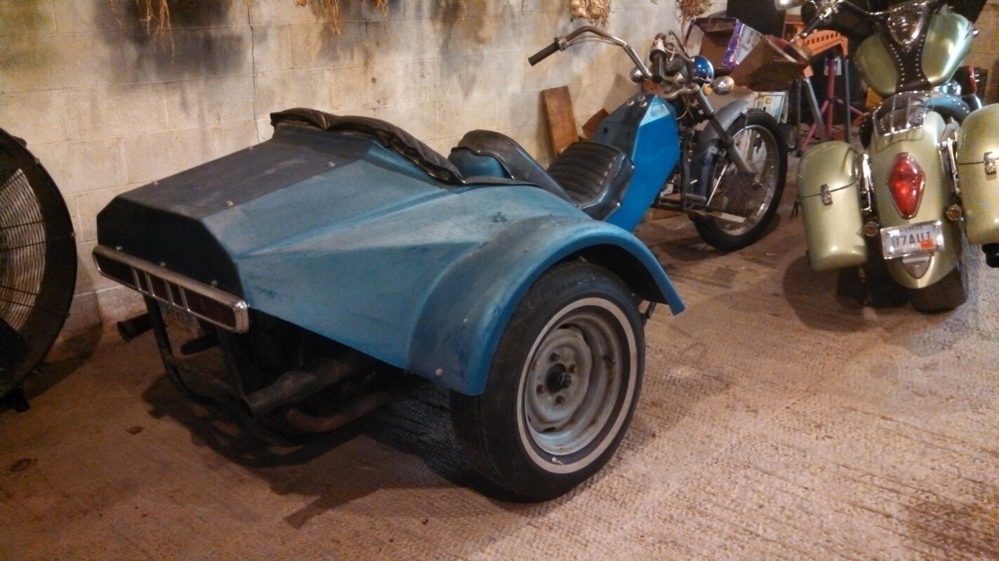

Here's a couple pics too:
I don't know much about VW hybrids, but I think you have a home brew trike. Nice find by the way - I'm jealous.

Motor is a basic Type 1 (Beetle) 1200cc manufactured in Nov of 1963. That info was gathered by VW #/code lookups and confirmed by enhancing your second picture a bit to show the engine under the fiberglass body.
You have the base equipment for a great trike and the value is enhanced a bit by the automatic transaxle. If you are building it for your own long term use, you might consider exchanging a 1600cc dual port engine for a bit more pep. The 1200s were good dependable motors, but do not offer great low end torque - although they will get you an extremely high MPG.

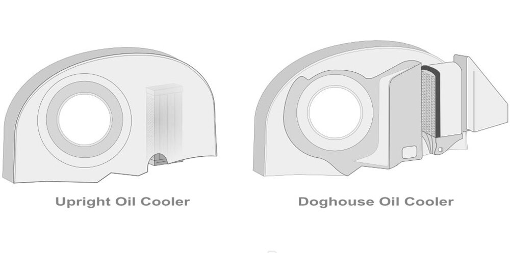

Is it a 6 volt or 12v system? A '63 was 6v but a lot of them were upgraded to 12v. Look behind the fan shroud. If it is not a doghouse fan shroud it is '60s engine. I've read that the old style doghouse blocked air flow to the #3 cylinder causing it to run hotter. I've also read that VW supplied them with a distributor with a 3 degree retard offset on the #3 distributor shaft lobe to get it to run cooler but that may just be VW folklore. The cam rode directly in case bores, no inserts which is not a good thing. The 1600DP and later engines are much better but hey, run what ya got til you need a new one.:laugh:

Keep in mind Vw driver, that all the stock factory single port engines didn't have the "dog house" style oil cooler. It was the older design. So it doesn't necessarily mean it was a 6 volt system.
