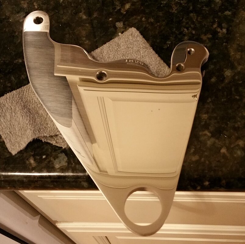

Good morning to everyone, well I got my brake stay back from the machine shop. Not a happy camper about it.
Took it in looking like this
and after getting home I noticed like 4 deep dimples, took it as marks from a vice.

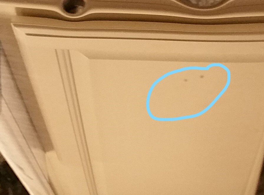

Now it was shinny, but I have spent 2 hours or more with the sander and 50grit paper and they are not as deep now and I have only these two dimples on the surface now, bummer I still can see the other two shallower ones, but they will work out.
They are a bit dark because of not being rinsed off good, but do I keep at it and get them worked out or just a bit less deep, or do I just finish the working process to the 2000 grit finish and polish it out ?
I do not see a scratch polish filler helping them, not at this depth, or does one do a spot fill weld and work out the piece out than ?
Am I being over critical about it ?

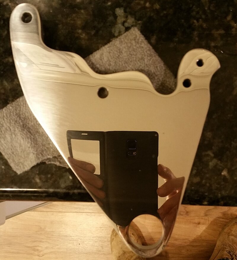

Holidays have taken up some of my time, but here and there I have kept at finishing this brake stay.
The 1500 grit paper seems to take longer than the 1000 grit, so I think I am looking at a few more days of it for sure.
I did not get to work out the dimples all the way. I will save all the little in-perfections for another time.
I did not clean them out a bunch so they showed up in the pictures. They may not be noticed much at all once all is finished, cleaned, and polished out...…..okay that is what I hope for now at this point. My body has been letting me feel my age and lack of total exercise...….my shoulder joints do feel all this work, LOL
That looks great you have more patience than I'll ever have. I don't know if anyone would notice those marks. But of course you know they're there and we all know how that goes.:) We have oil and chip roads here. When they do them in spring time, they throw so many stones up I actually stop at the end of my street to empty my shoes out.:laugh: They would probably add enough patina to that so you wouldn't even notice that. Keep up the fine work.
I will 2nd sidecarbill regarding super finishes, The 2 small blemishes would not bother me either. Now the machinist should have known to pad the jaws if the part is used where is can be seen. The other side of the coin, is, if the part gets loose in the vice when working the part, you ruin the part, and most likely wreck the tool in the spindle, now everybody gets ugly.....welcome to the machining business!:xzqxz:

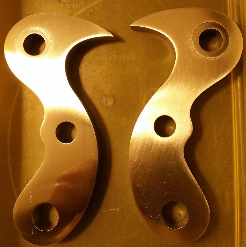

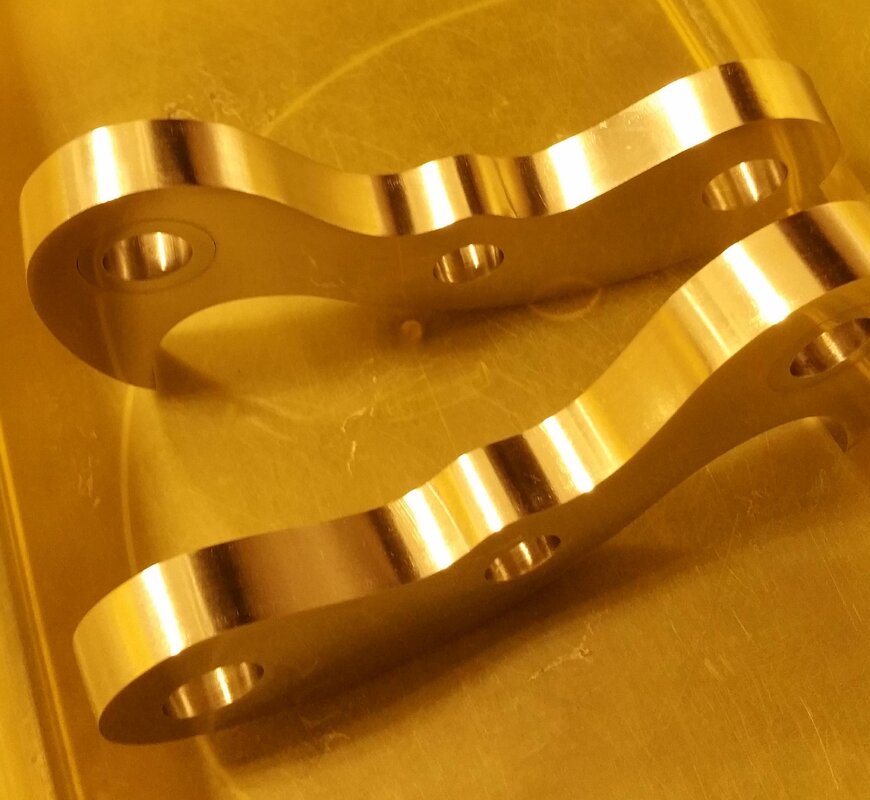

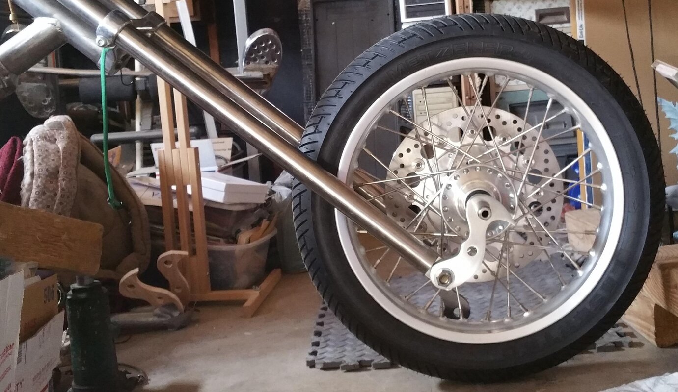

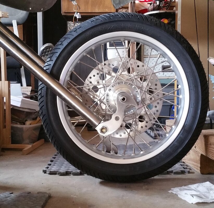

Okay have some things back and been working on the rocker's, finishing work. Some pics of how it may all look.
another look, it is almost in position right now just on look see
Now to finish sanding and buffing the rockers out and the down bars need some buffing still.
Like always, I have a few things I would like to be done different, minnor stuff that should be done for proper function of the suspension.
The water jet cutting of the rockers is clean looking, still need to do the edge finish work, but it was worth 60 dollars to have them cut out for me. It took me days to cut out the brake stay and I did not want to do the thick rocker material.

Okay a few pics of how the rocker's are coming along. I got the out edge work done and have been trying to work the metal, but again I see I could have went longer with the 50 grit. So I will just finish them out in hopes all is not to notice able.
The extra shine to the edge came from a jewelers cloth my wife told me to wipe it down with. It does look nice, but not a true deep down shine, so yes I will work them to that point I hope...……….
I can see a few spots from them being welded together for the drilling of holes, but it worked out mostly, than there is the clamp marks, well they might not be, but there deeper and the problem I keep trying to work out is what I call "pitting" little holes on the surface. I think the are created when the metal is poured ………….. either way I have to live with some of it, at least for now.
