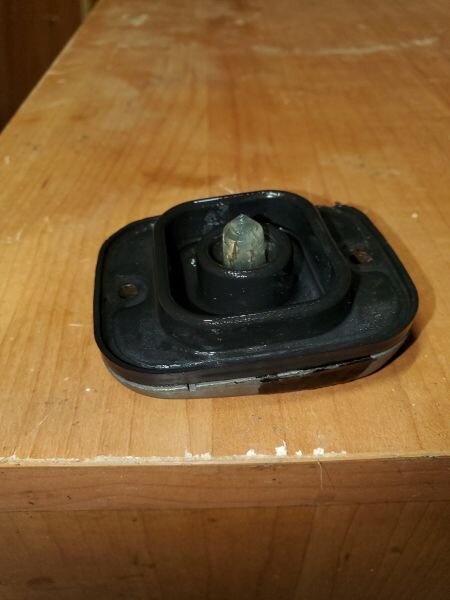

Pulled the cap off the master cylinder, and yes, it looks dirty. Master cylinder is at an angle, so naturally the cap came off along with a bunch of fluid. Not a problem, but with the mc angled like that, it will be difficult to fill at that angle. I do have a mighty vac, and can use that. I will be pulling the mc anyway along with the brake line when I change the ape hangers.

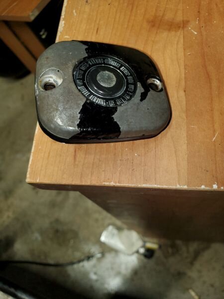

What is this in the middle of the cap? A sight glass?

To fill you turn the bars all the way to the left that will somewhat level out the MC. To flush open the caliper bleed screw after putting a tight fit hose over the tip. Put the other end of the hose in a jar that has about an inch of fluid in it. Make sure the end of the hose stays down into the fluid in the jar. YOU MUST KEEP THE MC mostly full during this procedure.
Pump the brake handle to force the fluid in the MC and the lines and caliper out the bleed screw thru the hose into the jar. Keep adding fluid to the MC and pump until CLEAN fluid comes out into the jar. Before removing the hose close the bleed screw. Now the system is flushed. Next bleed the system and hopefully that solves your problem. If not plan to rebuild the caliper and maybe the MC. This is a quick instruct. Just to give you an idea of the steps. If you have never done it before keep at until you get clean fluid and no air in the system.
PS. the plastic piece in the center is a sight glass for the fluid level.

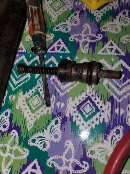

The trike is pretty heavy, with the way the frame is built...I hope that it's enough to keep the brakes from locking and the front end down. As for the mc, took it apart tonight...after fighting with the snap ring, got the plunger out...yeah, pretty bad:
If the master cylinder is that bad, the caliper can't be much better. Found a rebuild kit for the 11/16 bore on Amazon...just not sure if it works with DOT5 (would like to stay with that, since they could be from the same bike):

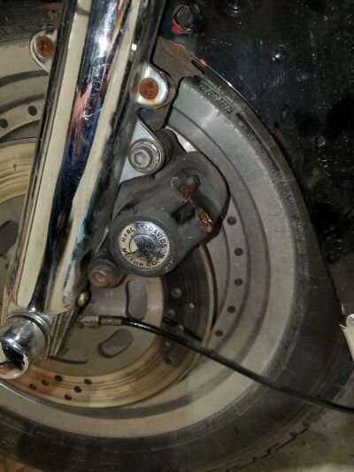

Pulled the front caliper, and tried to find a part number on it...can't find one. All I know is it is a single piston setup...not even sure it is from 2003 or not. Would anybody know where I could get a rebuild kit for this? It seems like it should need one, considering the condition of the master cylinder piston.
Went to local cycle shop today with the caliper and mc. Picked up a seal kit for the caliper, which is an older style from 84-99, and ordered the rebuild kit for the mc, which has an 11/16 piston. Good price on the seal kit, $8.99...rebuild for the mc won't be much more. Hope to have this all done next week, then move to the back brakes.
