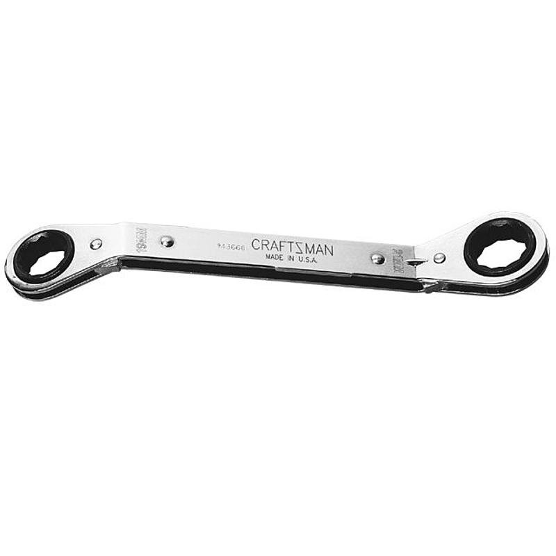

http://www.searsoutlet.com/1-2-x-9-1...49&mode=seeAll
Sears 43363 offset ratchet wrench 1/2" and 9/16"

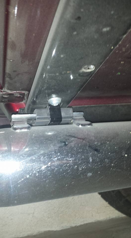

Just curious ..... can the square bracket (holding the rubber isolator) be taken off any easier than getting to the two 1/2
" bolts? If yes .... then it would allow the mufflers to drop down making easy access to the bolts.
The other side of that bracket is welded to the frame. It's just a plan old pain in the rear getting to these!!
