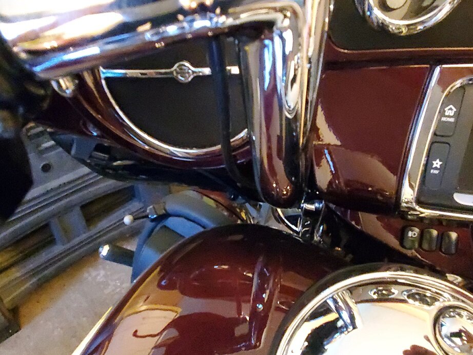

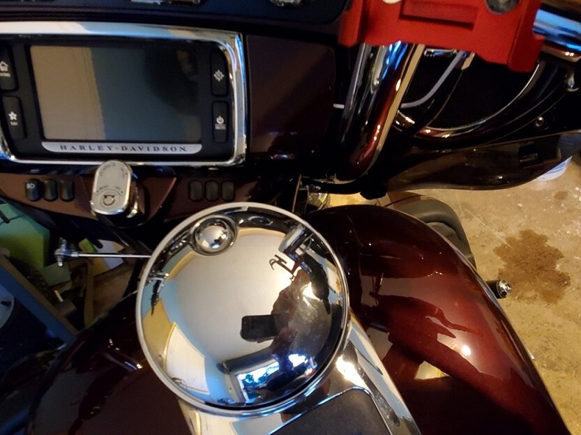

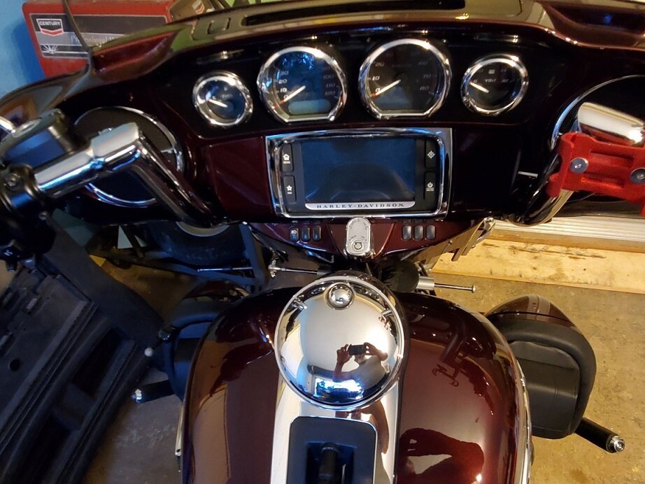

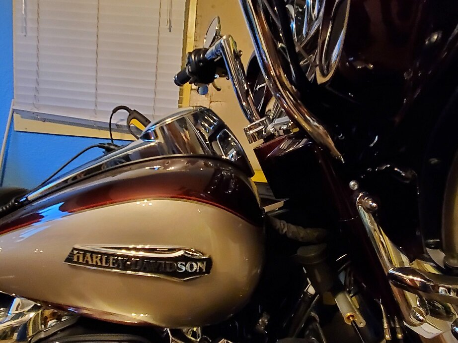

I also have heating issue. Wanting to start with a Tank lift. I believe I will run into issues :confused: with the tank lift hitting the handlebars when turning left or right. I have installed LA Chopper Twin Peaks 12" with 1.5" in dia. Been looking into DK Customs Deluxe Tank Lift. Here are a few pix's showing the clearance issues I am foreseeing.
View attachment 89738View attachment 89739View attachment 89740View attachment 89741
You can check for clearance really easily, take about 10 minutes, then you will know-
[FONT=&quot]1. Take the bolts out of the front of your tank.
2. Loosen (do not remove) the bolt(s) at the rear of your tank, slide the tank all the way back in the slots.
3. Turn your handlebars all the way to the left and raise the tank up your desired lift height to check for clearance issues.
4. Turn your handlebars all the way to the right and raise the tank up your desired lift height to check for clearance issues.
[/FONT]
Be careful when lifting your tank, you do not want to hit against something (forks, handlebars, trees, blinkers, etc.) when checking for clearance.
