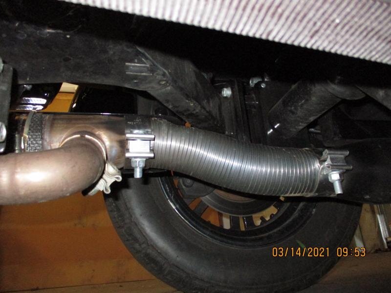

I took the connector pipe that goes from the head pipe to the muffler and replace it with a 2.5"piece of stainless steel flex pipe , I cut 1.5" of the end of the head pipe cut about 3 " off the muffler welded in a piece of 2.5" pipe connected it together, work's good no clearance problem the trike sounds so much better is so much cooler.
The original connector pipe goes from 2.5" to 1.5 inside diameter, the exhaust is just stuck there trying to get out . never found any body to do a tune I got a tune from Dyno Jet Then did 4 auto tune's it runs good now, spark plugs have a nice light tan color, ended up wit a 128 11.1 compression screamin eagle head's screamin eagle 64mm throttle body 5.5 injector's redshift 472 cam stock gutted head pipe wrapped the exhaust S&S race muffler's .
there's a swap meet coming up in april if the dyno guy is there I will get a dyno run to see what the torque is ? it is rideable at all speeds the woods 408 cam does not work in a trike! The power is crazzy , getting around 30mpg Now Im HAPPY I will try to post some pictures this week end .

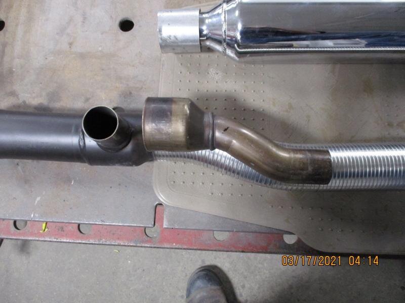

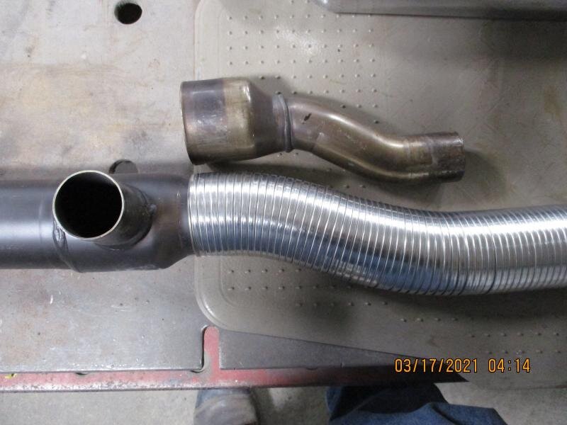

pictures of pipe
There about 165 miles from me ,I buy most of there take off part's . we have a swap meet coming up in April at Stafford speedway Dr Dyno will be there, I will have him Dyno it . I"m still trying to get a hold of Hulten's in N Y to do a real tune they may be gone to Daytona ?
Edited previous post and added pictures of the pipe

Its the same size as the touring right hand muffler, but I cut the end off my S&S muffler and welded in a piece of 2.5" pipe , Im not a big fan of flex pipe, trying to make one up out pipe is hard to get hose close tight bends. Theres about a 1/2" space between the swing arm and the pipe , I put a flat spot on top.

Are you concerned about how small the crossover is to the left side, and how small the left side connector to the slip on is?
Or are you viewing that as an overflow or relief for what is not carried out on the right side?

I took a piece of 2" pipe cut about a 1.5" long and welded it in two the cross over pipe inside to help scavage the exhaust

Its that way on all touring bikes I was concerned about the 2.5" id pipe going into 1.5/8 id ? It works for me a lot less heat and a lot better sound

I believe Krome Werks, and Dragos both have option for closing off the crossover pipe, essentially turning into a 2:1 system. Dragos recommends a special muffler designed for 2:1. D&D makes a 2:1 for Harley trikes now, as well as a 2-1-2 system. I have yet to see a pic of the intermediate pipe. The intermediate pipe is a bottle neck compared to normal touring setup. Shortening the collector and using a slightly bigger pipe with less of a bend might make one an interesting experiment. You could make something up like a stepped header in reverse to step down to a current trike muffler. There are a couple of places that sell kits for making custom pipes. Just talking out loud, lol.
