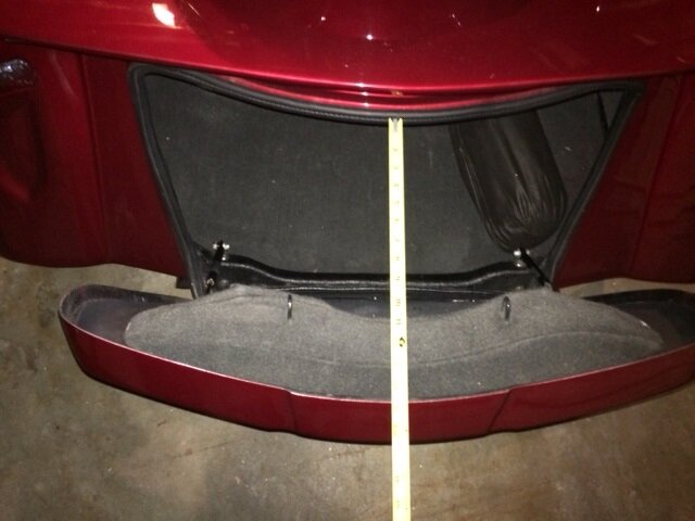

Need bigger opening

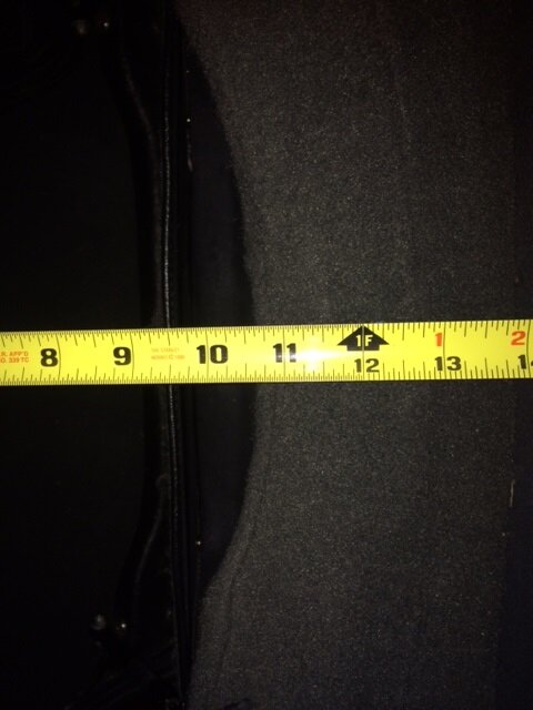

On my new (to me) 2013 Gen II Goldwing trike the pictures show the amount the trunk lid opens. This is ok for filling the trunk with a lot of small items but it's not big enough to allow full helmets to be put in there. Is there a replacement/longer travel trunk strut that can be retrofitted? I love this trike, just need a little tweak here. Thanks!Trunk 1.jpgTrunk 2.jpg
Elwood give me a call during the day. We have a different setup that should net you an increase in trunk opening
