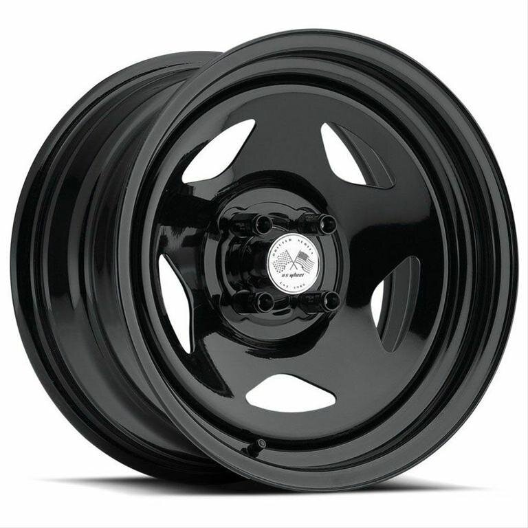

Can you tell me if this wheel will work on the Transformer Kit for my 2012 Road Glide Ultra?
U.S. Wheel 021 Series Drift Star FWD Black Wheels 021-7741PBLK.
Wheel, Drift Star, Steel, Gloss Black, 16 in. x 7.0 in., 4 x 100mm Bolt Circle, 4.500 in. Backspace.
Summit Racing Part Number:USW-021-7741PBLK
View attachment 29810Summit Racing Part Number:USW-021-7741PBLK
As Clint (Thanks much Clint ThumbUp) has already pointed out in another Thread, that Offset deviates @ 1.25" from HMS OEM Standard.
Call in and talk with our Chief Tech, Jim Gooch, about the Issues that may or will cause if any.
