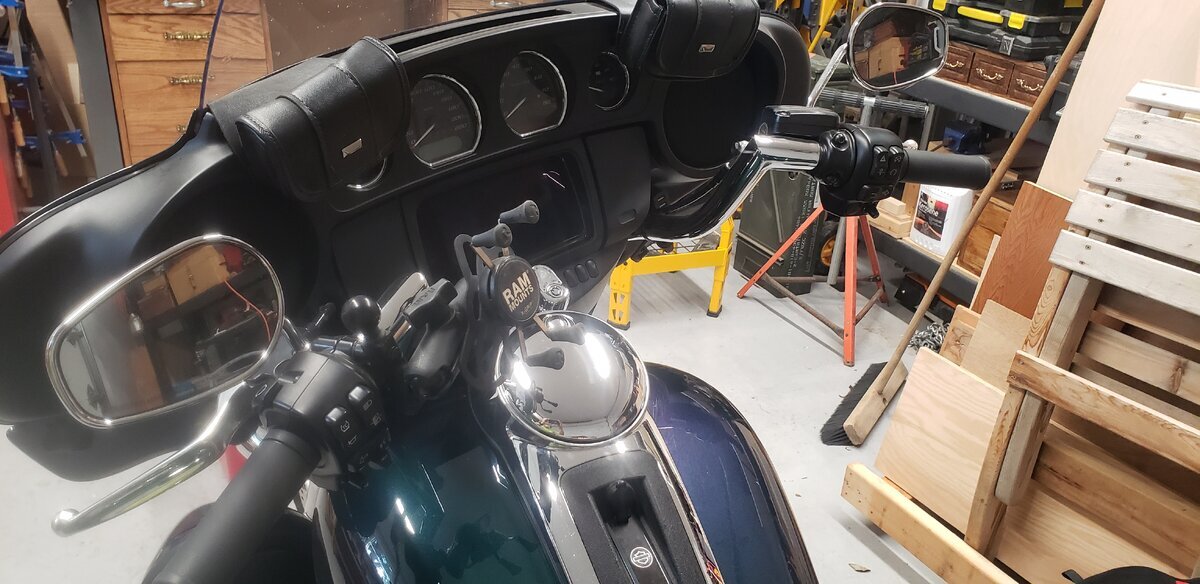

No extensions were required. They are LA Choppers bars, somewhat pricey but it's a long story on how that happened. Here are some photos if interested.
