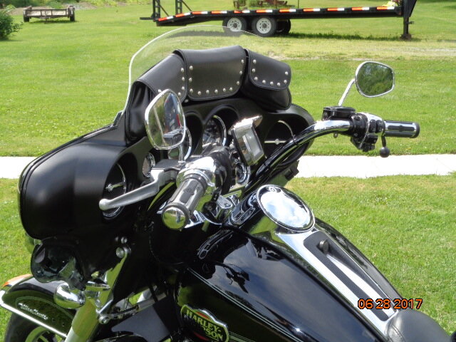

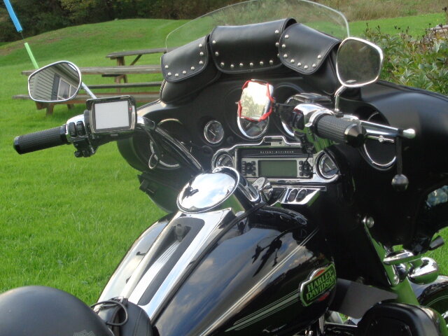

When I switched out my OEM grips they both came right off no glue on left side. Unless you glued the one's you are using on the OEM bars. DSC01024.JPG New Avon grips Love the Memory foam larger size and a modest price. Amazon
DSC00554.JPG OEM Grips were tuff on my hands ridges were the worst
P.S. I believe you will love the new bars I would not be without our's. Good luck Fred
