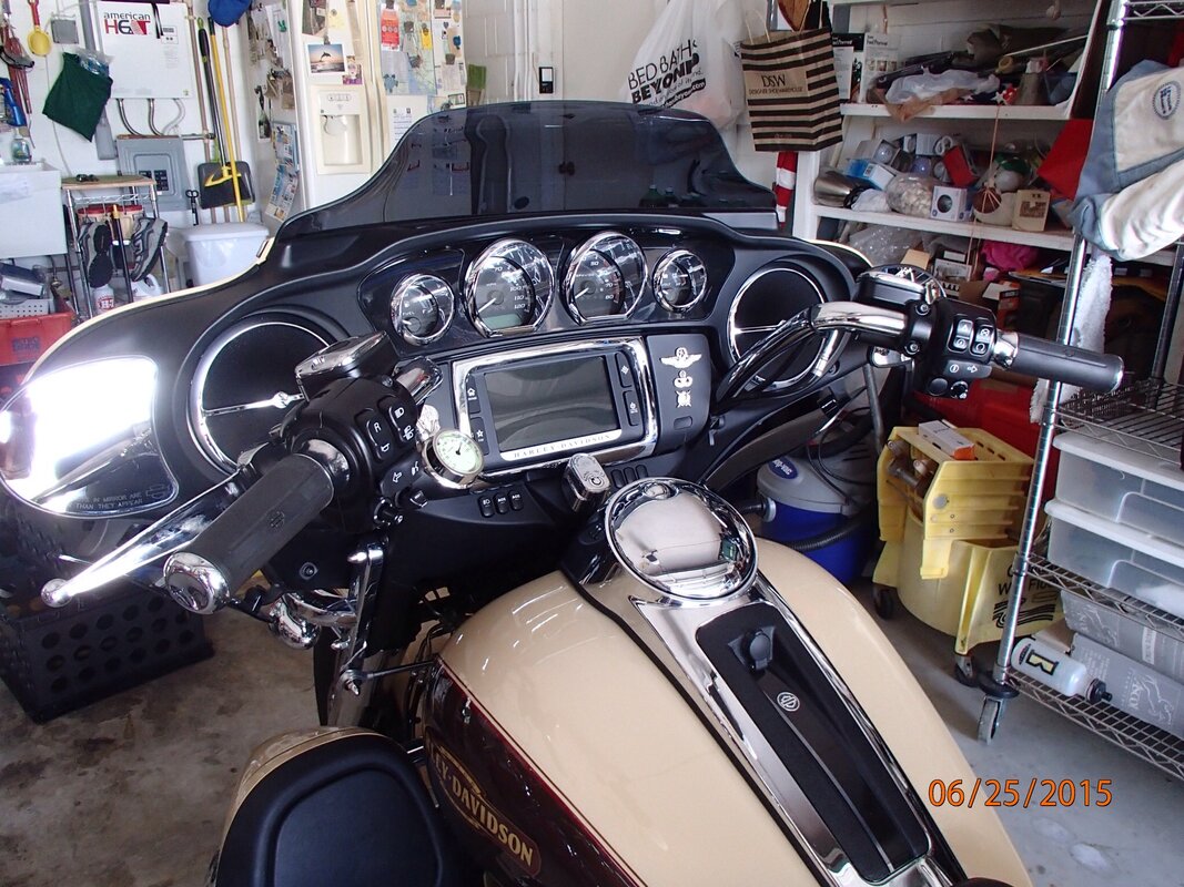

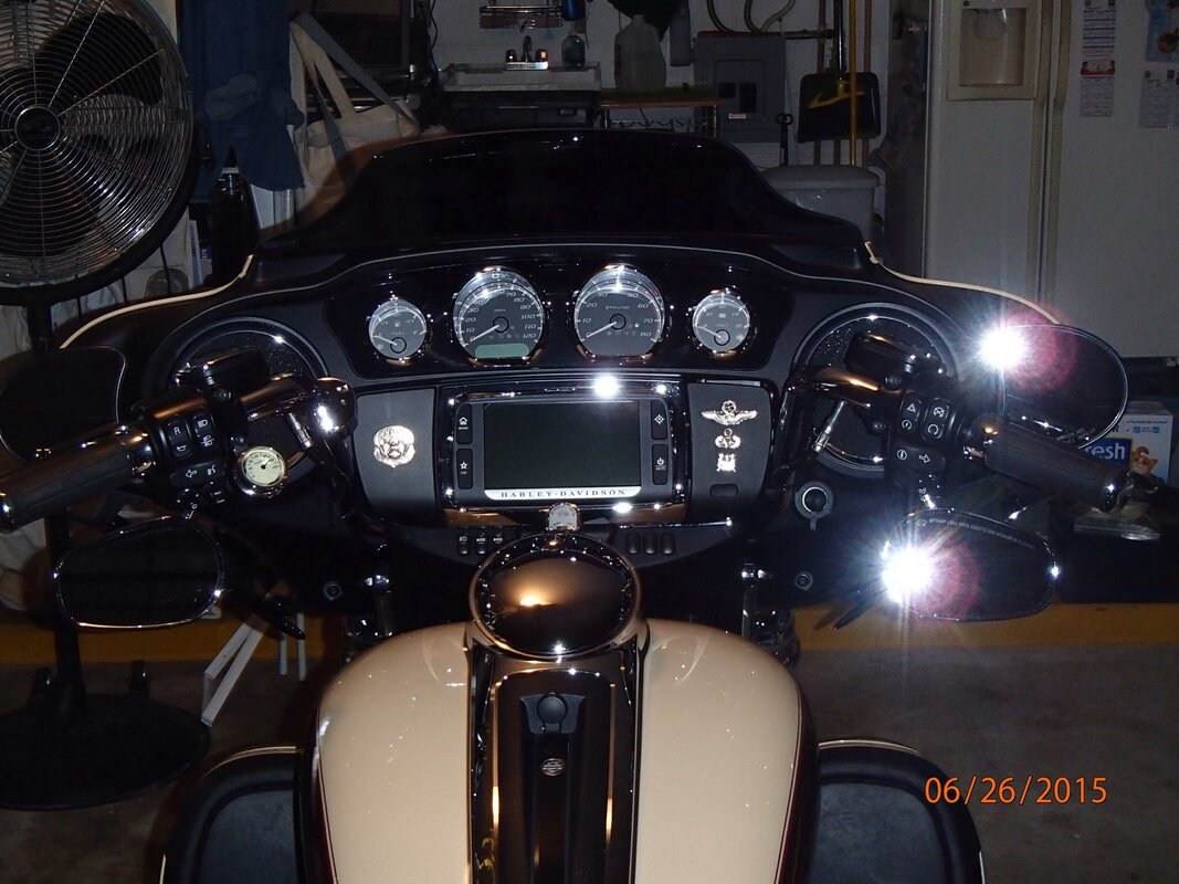

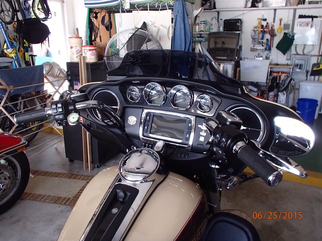

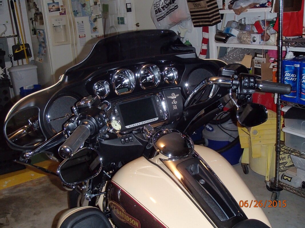

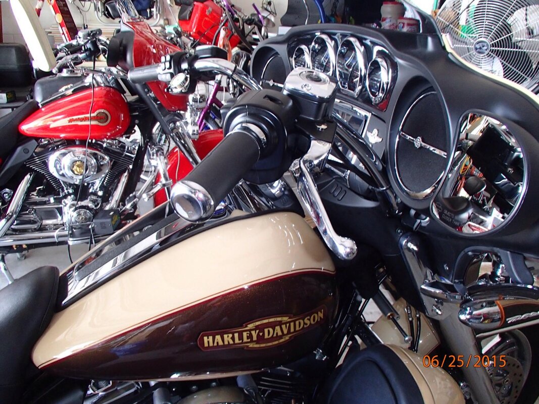

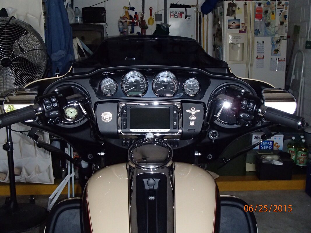

Picked up trike,very happy.Now I can sit up straight without my shoulders hunched forward.
Total cost of install $275.60.No additional parts we're needed,all stock wires and cables.

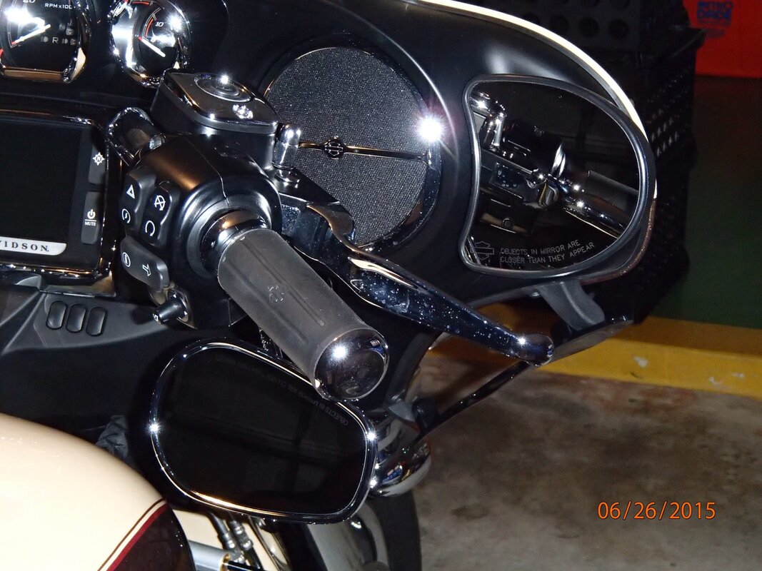

PJ73USAF, I have been looking a those mirrors, with the new bars are you looking at your hands or are they clear?
Good question,hands are diffently in the mirrors.Which causes a problem if you have the fairing mounted like I do.My solution was to flip and reverse the stock mirrors.There isn't any issue with the lower mirrors contacting the tank or anything else.
