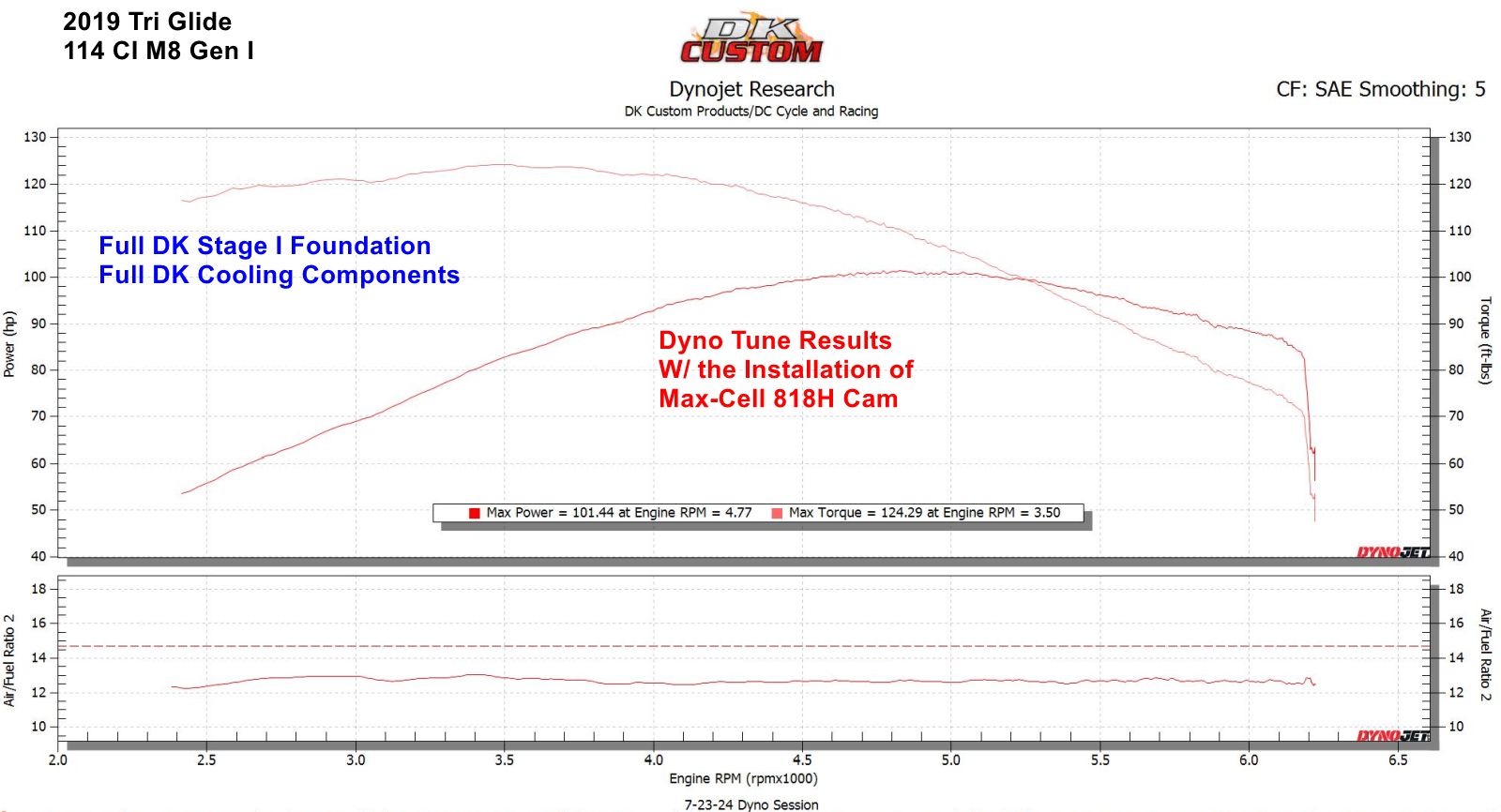

Finally took the time to get the 2019 Tri Glide on the dyno yesterday.

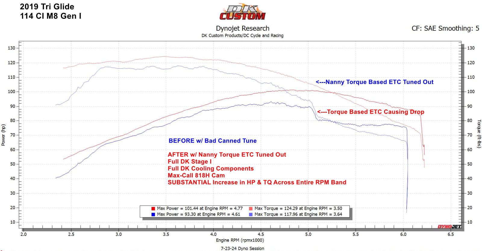

Did a bit of work on the tune. One of the biggest things we did was adjust the Torque Limits that HD started using in 2019. Made a very nice improvement.
101 HP
124 Torque
Very flat, and really happy with it.

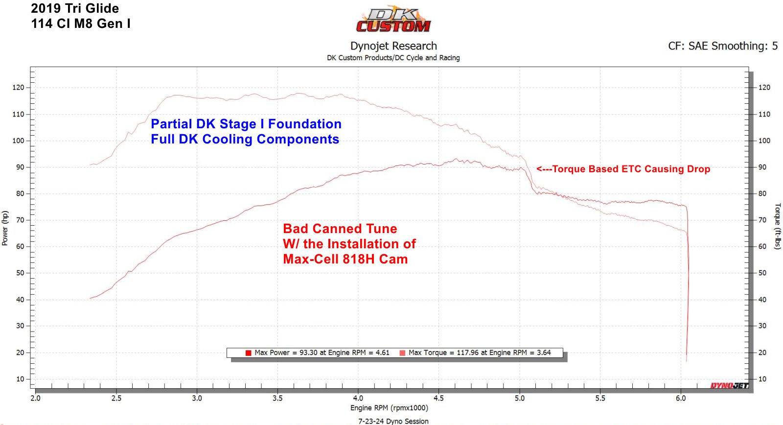

However, a few months ago I realized that my MPG were in the toilet...and this is usually a symptom of a bad tune. So decided to take it for a full dyno tune, since I could not find anybody with a good base map for a Tri Glide for this particular cam.

Also There are factors that change day to day and even hour to hour that effect what the dyno numbers are. Temperature ambient, Humidity, operator differences all effect what the numbers at THAT given run. Put the same trike on the DYNO a different day without changing anything and the numbers will be slightly different. Your DYNO run is a ball park figure.
The goal for us trikers is to get the most TORQUE out of the motor at the lowest RPM and get the curve to stay flat as long as possible. We want bottom end power unless you are into drag racing your trike.

This was the chart of the TG before going on the dyno-
After 1.5 hours on the dyno-
Before and After Chart-
