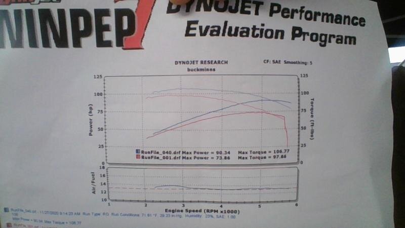

I don't have the CR480 cam but I am running the S&S 465 cam and I am extremely happy with it.
