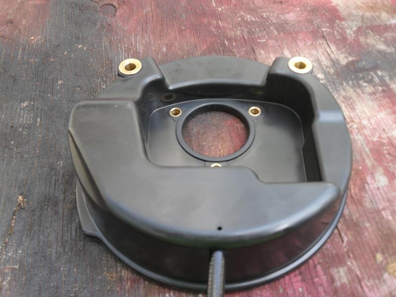

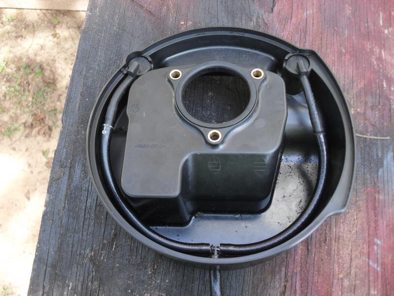

I have to open up this motor anyway. On my last trip, in the middle of KS to CO oil was blowing out the breather. So bad that oil was all over the right side including paint leg, boots, etc. When I arrived in Colorado Springs, CO. late afternoon. I spoke with the service manager about my issue he in turn brought out two motor mechanics for assistance. I thought it was due to the breather tubes under the valve covers. They said they would replace them but the real problem was H-D uses silicon to seal the lower cases. And a piece is blocking the crankcase breather tube. Engine needs to be disassembled cleaned and put back together.
Well, I wrapped a dipper around the back half of my Screaming Eagle air filter and road the rest of my trip with lots of oil and gas in the trunk. Finished the trip a little oily but got home.
This winter the engine, exhaust, cams or maybe a Streaming Eagle 110 upgrade.... or 120st change out is in order. I have a lot to learn before teardown. Thanks for all the information. DJ
I have to open up this motor anyway. On my last trip, in the middle of KS to CO oil was blowing out the breather. So bad that oil was all over the right side including paint leg, boots, etc. When I arrived in Colorado Springs, CO. late afternoon. I spoke with the service manager about my issue he in turn brought out two motor mechanics for assistance. I thought it was due to the breather tubes under the valve covers. They said they would replace them but the real problem was H-D uses silicon to seal the lower cases. And a piece is blocking the crankcase breather tube. Engine needs to be disassembled cleaned and put back together. Well, I wrapped a dipper around the back half of my Screaming Eagle air filter and road the rest of my trip with lots of oil and gas in the trunk. Finished the trip a little oily but got home. This winter the engine, exhaust, cams or maybe a Streaming Eagle 110 upgrade.... or 120st change out is in order. I have a lot to learn before teardown. Thanks for all the information. DJ
That is the 1st I've ever heard of that, I get this feeling someone is blowing smoke up your back side. Normally when they start passing a lot of oil out of the breathers its one or a few things. It could be a bad flapper valve located in the rocker box on top of the rocker support. It could be higher than normal engine oil level, someone put to much in. The scavenge side of the oil pump could be damaged which is causing excess oil to remain in the sump. Sumping can cause excess heat and sluggish performance. It could be excess leak down on one or both cylinders due excess wear on the piston rings. You can diagnose excess leak down by doing a leak down test.
