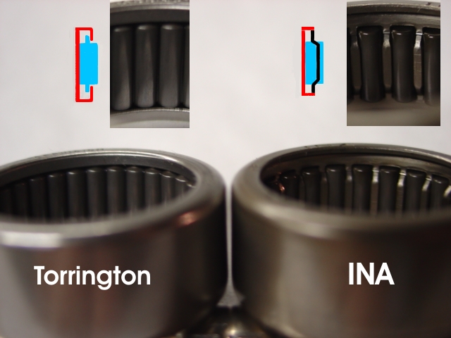

Yep, the cam bearings will be changed as part of the normal cam swap, I was wondering if the OEM bearing design would tolerate the runout requirements of a cam with shaft tolerances designed for gears vs one designed for the slop that comes with a chain. The OEM may not work (from a geometric dimensioning and tolerancing standpoint)
OEM should support the cam, tho the Torrington bearing has more surface area
The bearings are bigger than stock to prevent cam walk and better support
Note no spacing between rollers unlike the stock INA bearing

OEM should support the cam, tho the Torrington bearing has more surface area. The bearings are bigger than stock to prevent cam walk and better support
That is what I was talking about THANK YOU Jack. That gives me a leg to stand on when talking pinion run out for gears vs chains! Glad you love the details. You enrichen this web site and forum. Papa Zook ... give Jack a raise.
