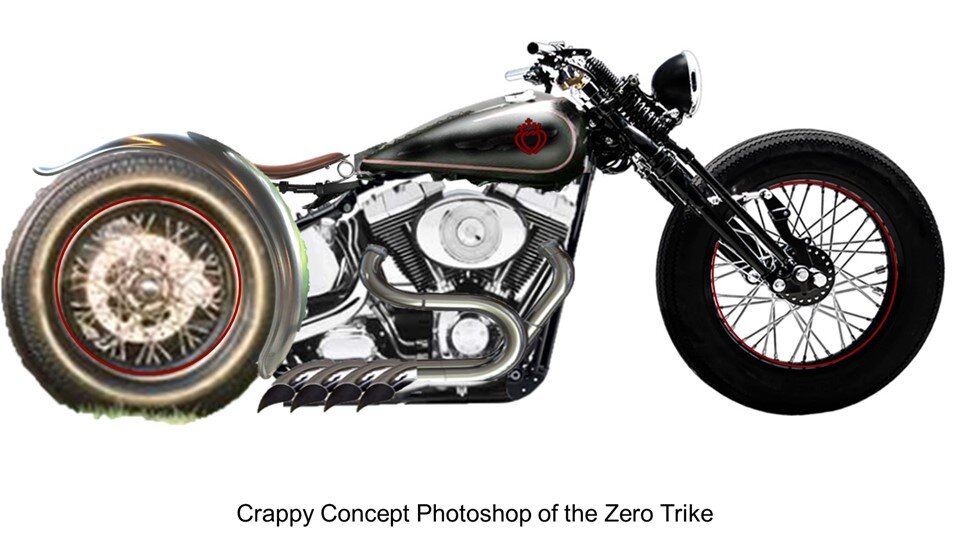

Thanks. I have started a new one....it has its foundations in a 2000 Twin Cam Springer Softail....an oldie but a goodie. As I tear into it I will post progress in the "Harley Conversion" forum
Here is the traditional crappy photoshop of it... My Zero Trike

Thanks! It has the springer on it already... it is a 2000 FXST Springer Softail. I am cutting the frame front and back. Putting a Zero Style Dragon Neck on the front @ ~41-45 degree rake (trail will determine) and a rigid x-frame in lieu of the softail swingarm to accept the Independent Rear Suspension axle in the back
