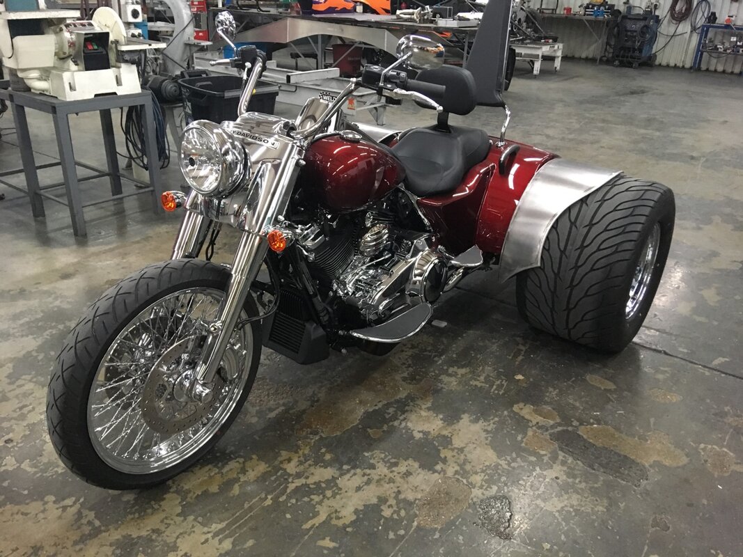

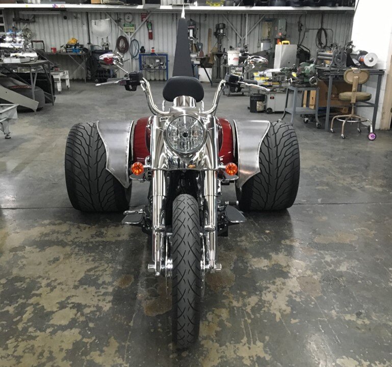

Ok.... things have been kind of slow lately on the project but they are spooling up....

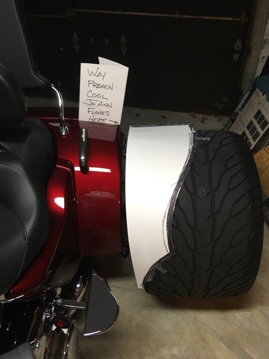

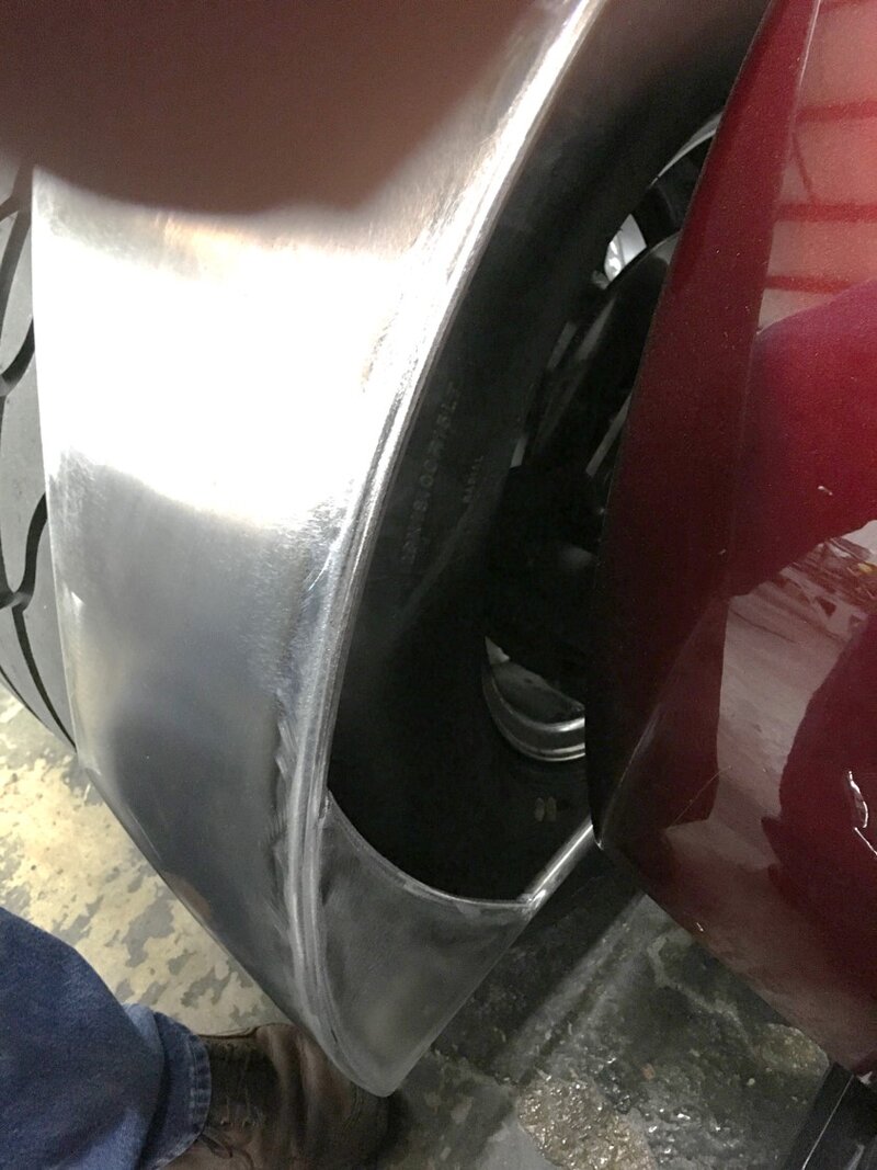

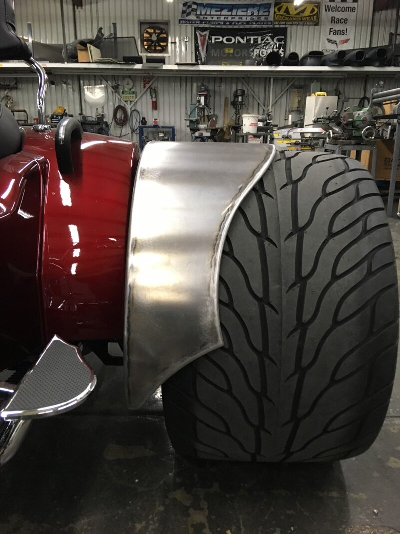

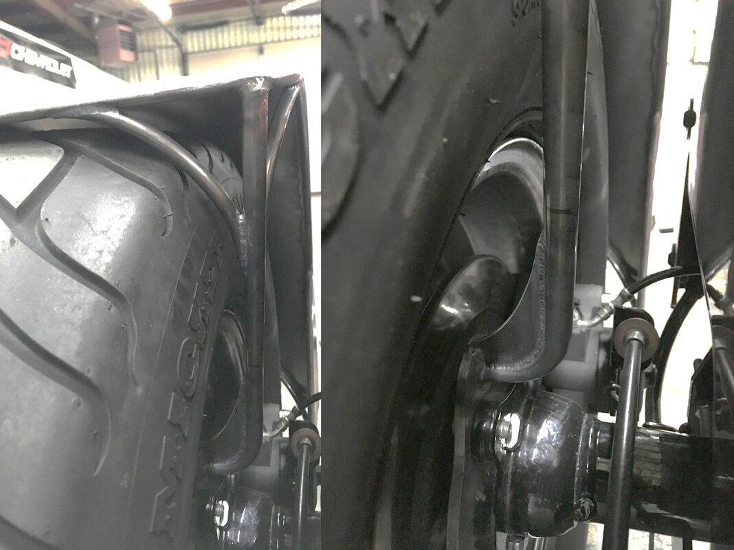

The trike is at the fabricators getting rear wheel fenders made. Essentially they are frames that attach to the caliper reaction brackets in the back and rear fork (swingarm) at the front that are skinned in sheet metal
The guys at Jerry Haas Racing are building them for me as I don't have that kind of equipment anymore. Here is the pattern laying on the tires (The posterboard was kinda floppy...but you get the idea)... I want to show a lot of rubber. The fender will ride with the differential and be spaced ~ 1/2" off the body

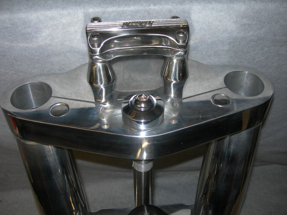

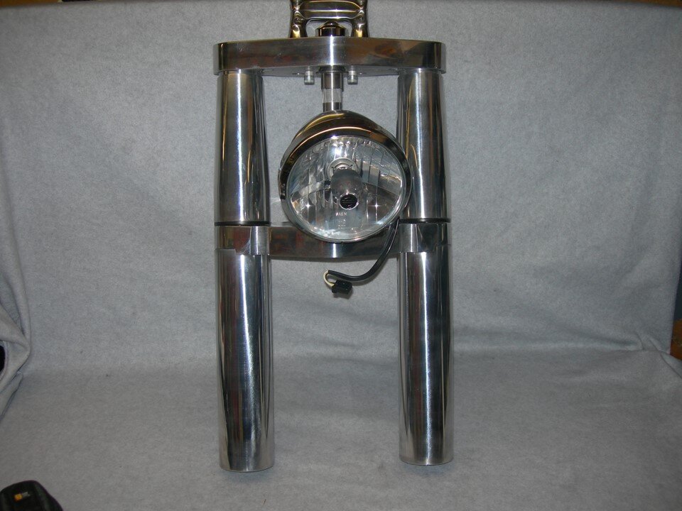

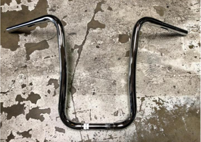

The front end trees were finished today .... pictures forthcoming... and my 1 1/4" x 18" Smart Gimps from Nash are at the chromer

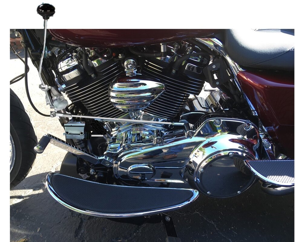

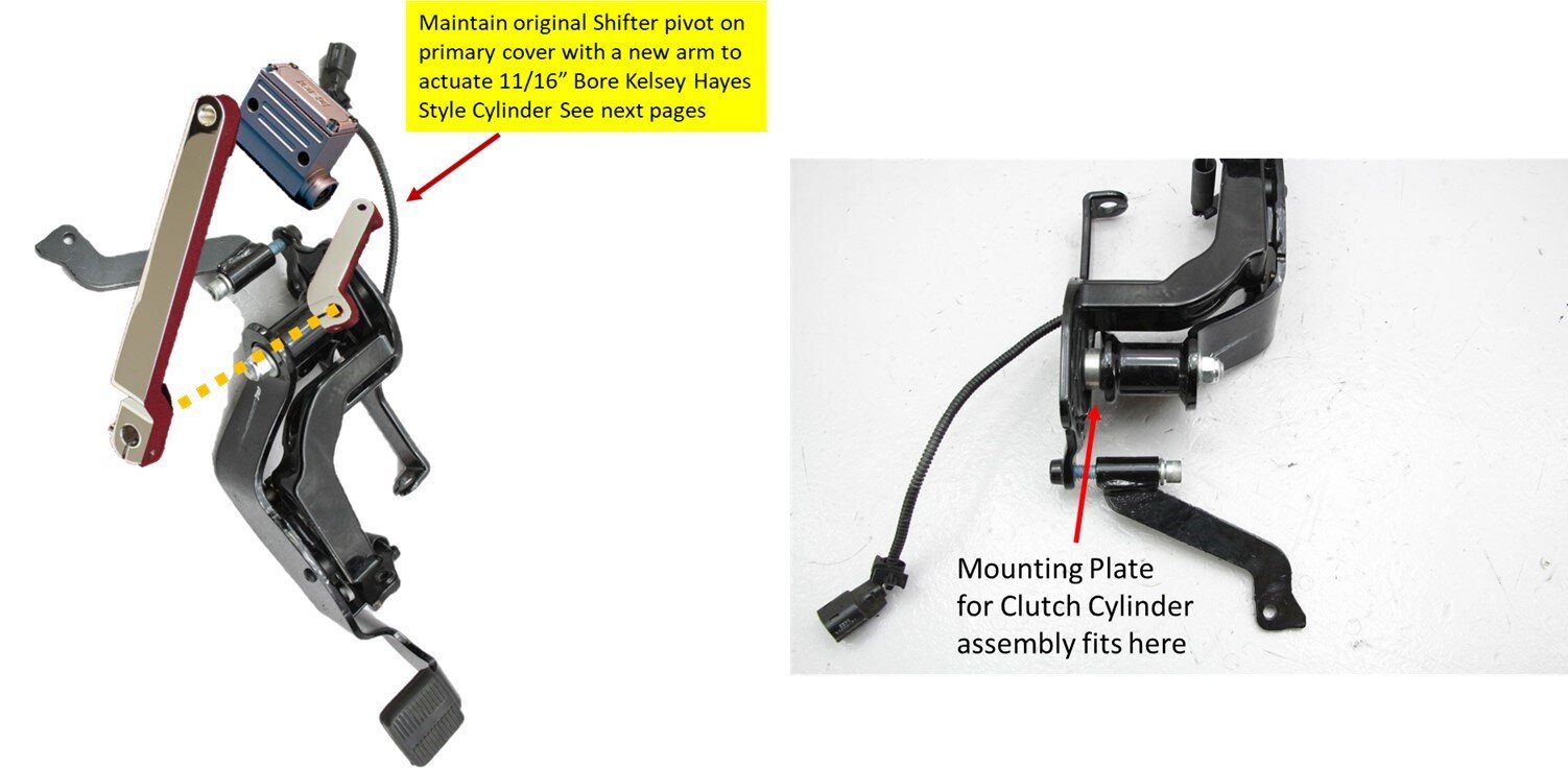

The other breakthrough was the discovery of an 11/16" bore Kelsey Hayse style master cylinder in Sweden! That enables a hydraulic foot clutch!!! So my next science project for the trike is a police style jockey shifter arrangement.... Here is the concept
We are machining a bracket that ties into the parking brake pedal mount and uses a new front arm on the shifter pivot to actuate the clutch and I am modifying an FLT Police Shifter set up to accommodate the 1 3/8" front tubes on the FLRT. I want to replace the round shifter arm with a MOPAR Hurst shifter stick as well.... I will keep you posted and will upload pictures as things progress.....
