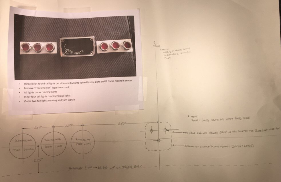

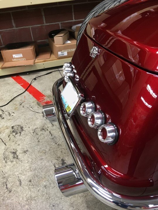

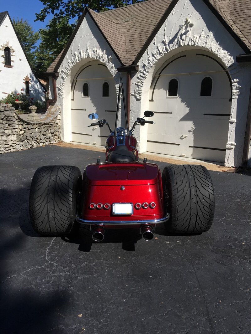

I really dig those tail lights....Did you get them to blink in sequence yet?
Not yet. The guys at Namz (Badlands Modules) are working on one but it is not released yet. I volunteered to be a guinea pig, but the took a pass on the idea. The United Pacific Sequential LED Light Kit was not compatible either. So the outer two are running lights and turns and the inner four are running lights and brakes.

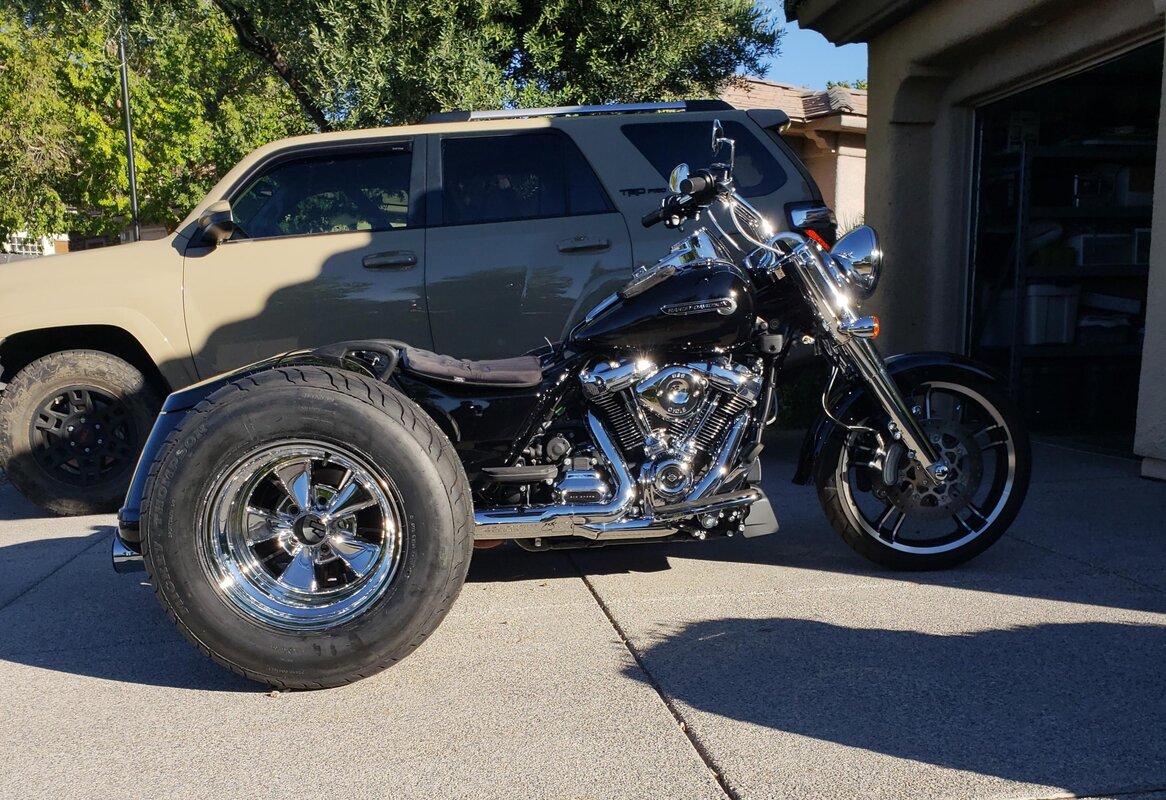

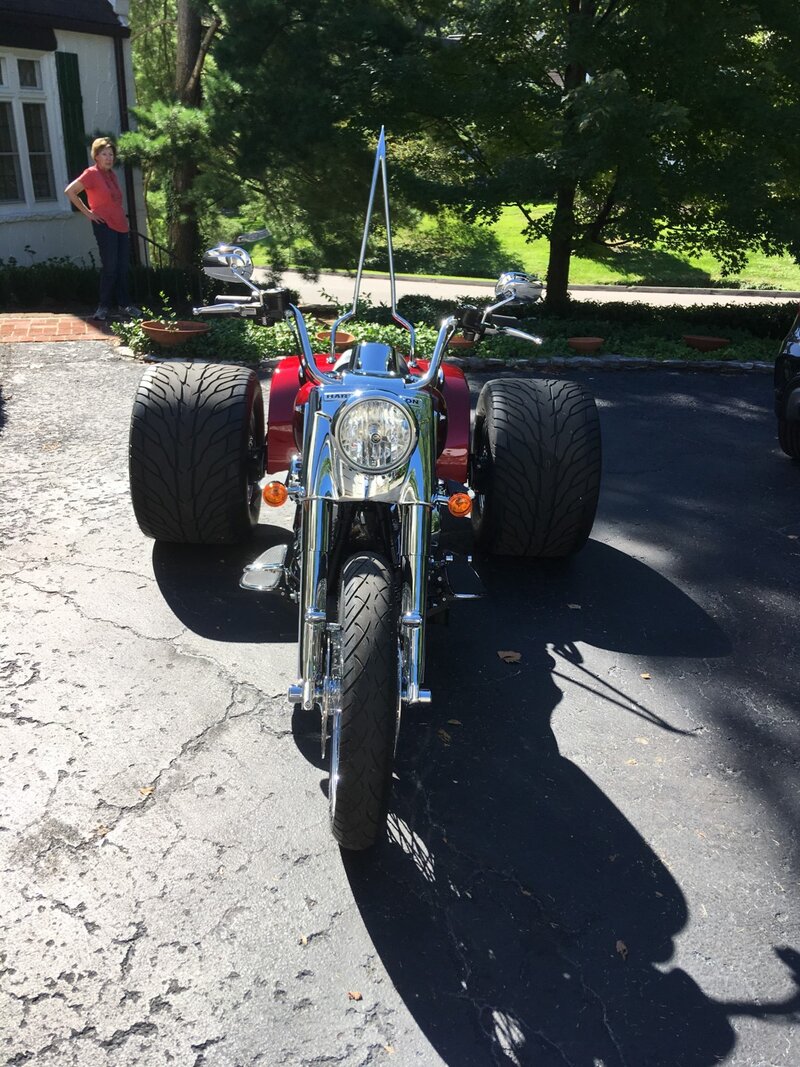

WOW!!!! That looks insane!! Those tires and wheels really stand out (no pun intended). As you get further in your build you get me motivated to get mine finished. Waiting on second tire to be delivered and going to measure for the hubcentric rings. Did you get a set for between freewheeler hub and adapter AND between adapter and wheel? I have the same wheel in a 10". Lets see that bad ass sissy bar!
Yes I did I turned down a piece of tube stock to make the inner sleeve for wheel to adapter (see picture). But my adapter design required it. Then the hubcentric rigs went from Trike hub to adapter.
Thank you. Have the same adapter also. My Calipers won't fit inside the wheel to measure hub! Going to call Cragar for the specs. Hoping to have this issue taken care of in next 2 weeks. Weather is changing here in Vegas so need to be on the road.

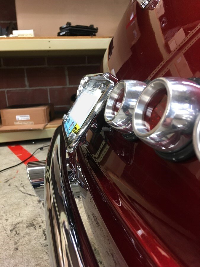

Free Bird, would you mind posting a side view of the back of the trunk, I am looking to do a license plate mount like yours on my Wifes Freewheeler and she wants to see how far it is off the body. Very cool build by the way, I tried to get her to let me do wide tires on hers but she isn't buying it "yet" hahaha.
thanks Jason

Got it... thank you again. Great to hear about the ride. Any noticeable difference around tight curves from stock tires? I imagine you need to be aware of the extra width of the trike now also as compared to stock. I'm sure I'll bounce off a few things until I get used to it. Hubcentric rings ordered and hopefully won't take too long... they had to be made to size and I got the aluminum instead of plastic. Thanks for the updates!
Yes.... I will win the rooster tail contest.... I actually am interested in how bad the hydroplaning will be. We have not had a serious rain since the tires were bolted on but I have a park nearby that is going to become a test track for driving and controlling the wide tires in the rain....(Thanks for the idea Kevin... saw the Tri-Glide snow video)
Honestly no. Even reverse works well. I was trying to maintain the setback on the wheel to be same as the stock design so as to keep braking dynamics and moments the same (except for the extra weight) as the stock wheel. It corners really well, steering effort and response are not affected as for as my senses can tell. I was no more or less fatigued by the drive through the twisty turny roads in Calhoun County Illinois.... So unscientifically, I would say ... It turned out OK
You do have to be more mindful (very) of staying in the center of the road. I only have a foot on either side. Kinda like driving a dually pick up.

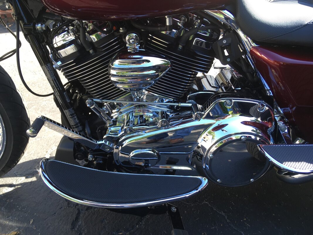

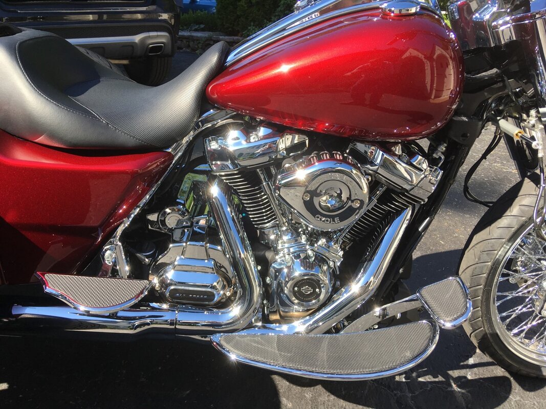

Fantastic. Are leaving the floor boards on or going with forwards?
I replaced the stock floorboards with CycleSmith Banana Boards & Matching Brake Pedal and the stock passenger boards with Supreme Legends Floorboards. The Controls are a Kuryakyn Extended Brake Pedal and a Baker Custom Extended Shifter Arm & "Old No7" Extended Shifter Peg. Very comfortable ride
