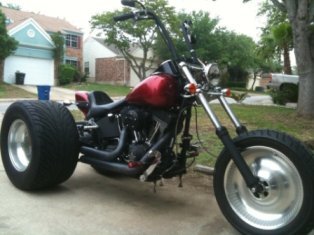

2003 Harley Deuce, TC88B, 34" Frankenstein Hot Rod Rear
Vance&Hines Big Radius 2-2: Fits with no clearance issues
Vance&Hines Big Radius 2-1: Will not fit - swing-arm / muffler mount interference
Vance&Hines Competition Series 2-1 (stainless): Fits, great performance and

What about the CFR SHORTY 2 into 1 exhaust system that is the one frank uses and is on some of the vrods in their picture gallery? I have Samson street sweepers now and I trying to make brackets for the tail end piece.
V&H Fishtail Softail Duals worked great on mine. The rear muffler tabs had to be extended just a tad to lower the rear end of the mufflers below the rear axle. I get tons of compliments on how old school hot rod they look between the rear wheels and they sound pretty nice too.

I modified the turn out exhaust end pieces. I cut off the pipes to the mount brackets. There are baffles in the front pipes. I did not want to spend $450 to $600 for new pipes and then have to download new maps or get the v rod dyno etc. Here's some pictures .

That's a good start. I hope you like the sound and total performance. good job measuring glad that you did not have to make it fit. My 20# sledge hammer made the final adjustments for me. LOL Jay
