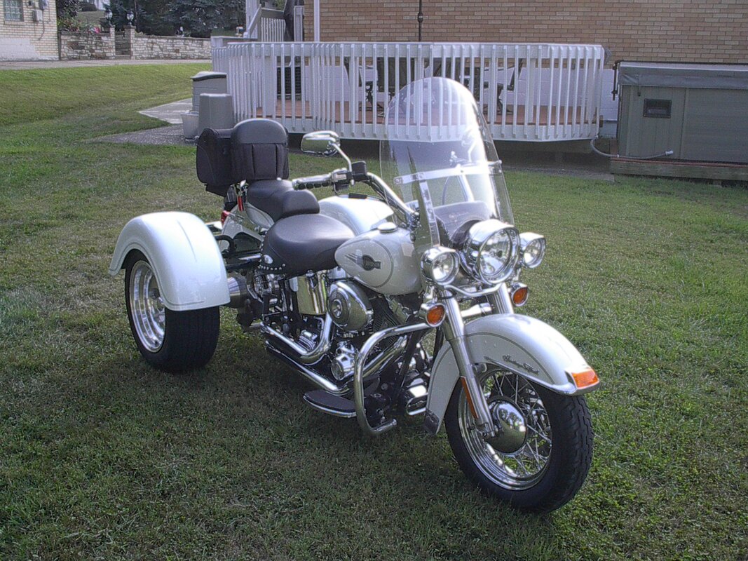

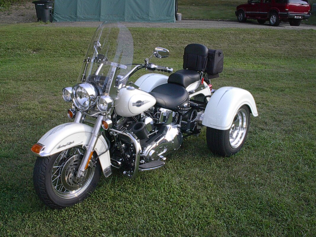

My wife has a 2006 Softail that we converted with a Frankenstein Kit. The kit is top notch and so is there customer support. We have had no problems with anything. It has quite a few miles on it and is one of the best I have ever ridden.

How many miles. did you do the conversion yourself? Was it easy to do? Did you use the racked trees and if not how is the steering?
We did the conversion ourselves. Very ez to install. We added the ez steer triple trees and it steer's good. A little more effort but you get used to it. Mileage is around 1000.

Trike looks great. I have a freewheeler right now but I wish I would have gone with the Frankenstein really looks like an old school hot rod and I bet you don't have the heat from the motor as much
Its running a stock 88TC with a 5 speed. I installed a Power Vision with a map from Fuel Moto. If we keep the speed to a max of 65. We get about 34 MPG, Sometimes I would rather ride it than my Ultra Classic.
