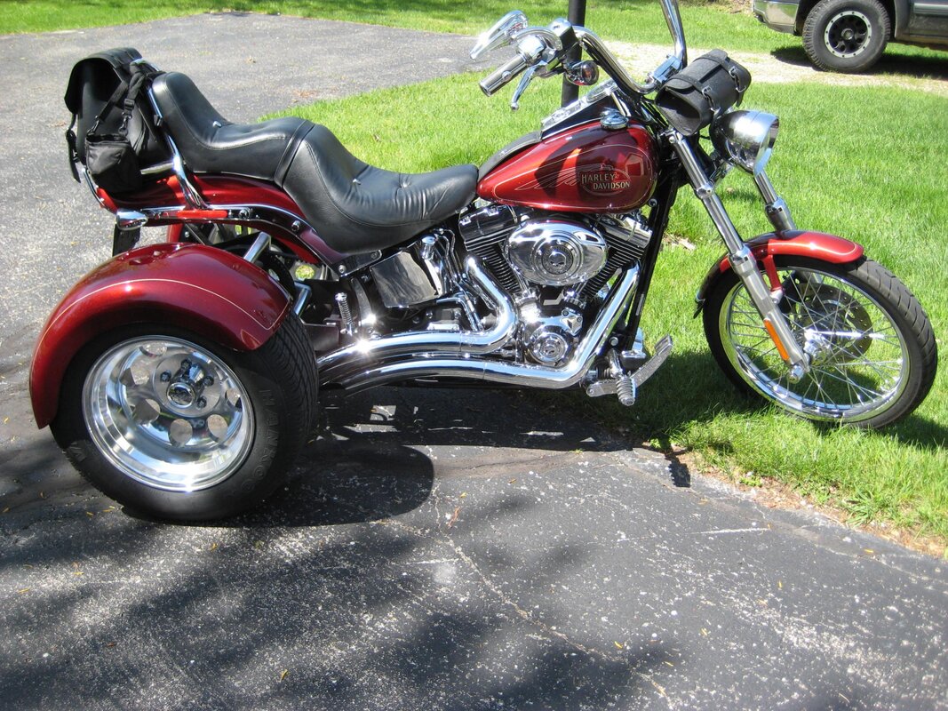

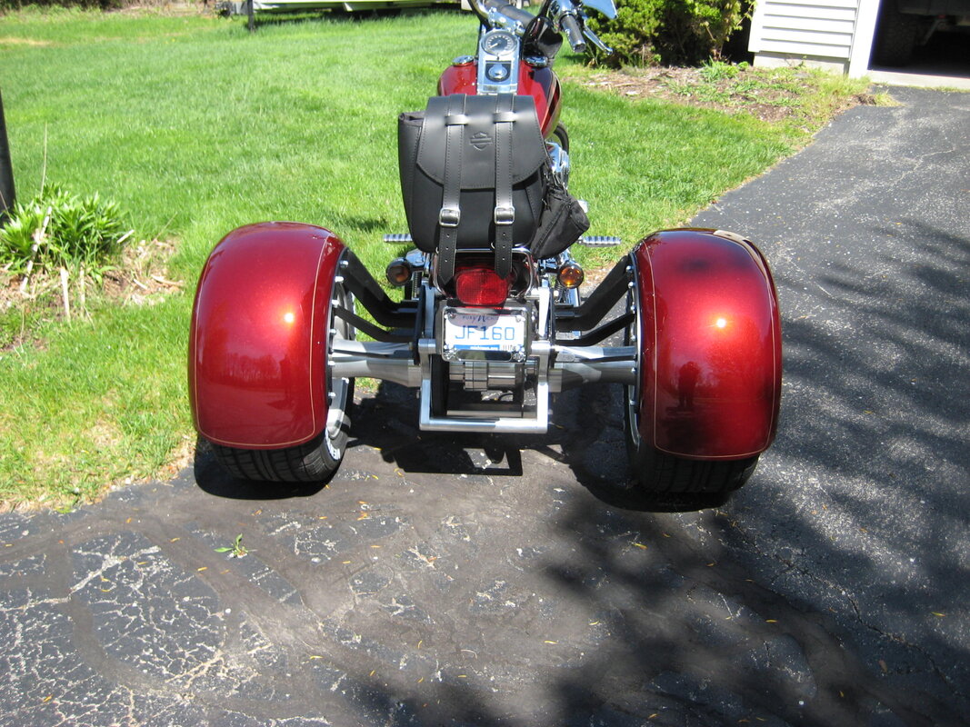

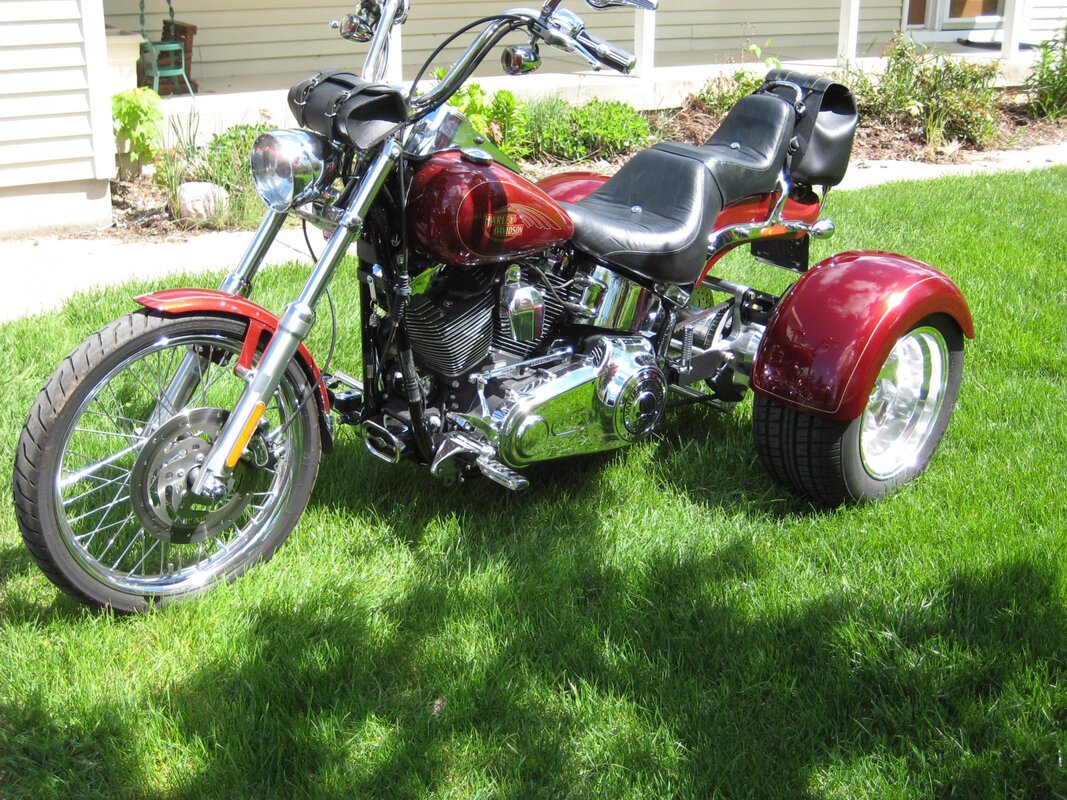

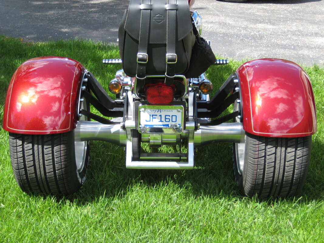

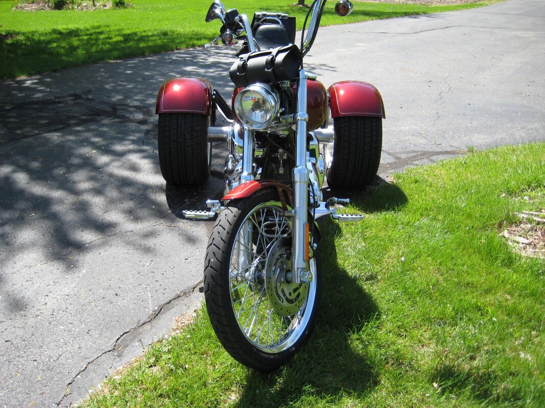

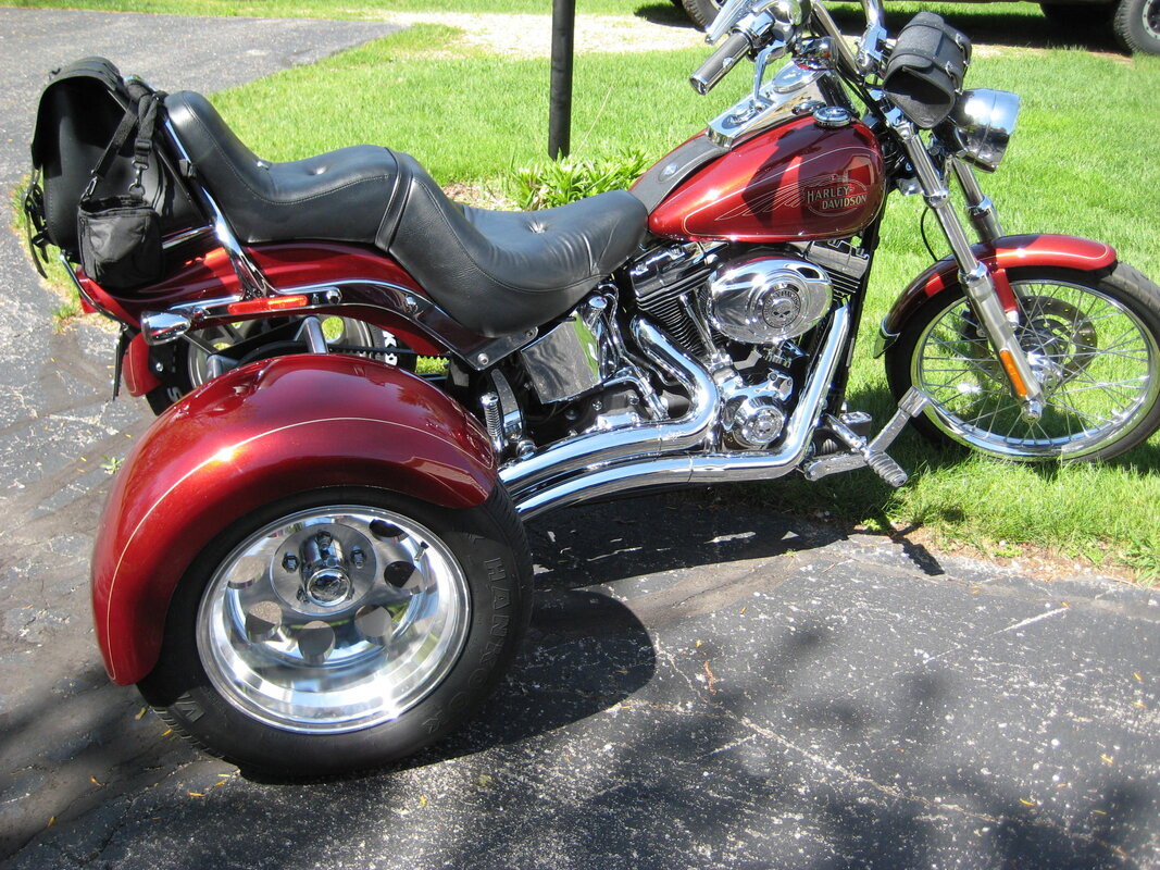

I have removed the brackets twice and changed where the fender bolt to the brackets twice. I do believe I finally got it where I want it.trikefenfin11.jpgtrikefenfin5.JPGtrikefenfin9.jpg

Ok My trike is ready to be rode, everything is done except the fenders are still at painter's. I can ride with out them , finish date for fenders is 05/30/2017, I have know painter for many years, we will be swapping work for this job, I will make a adapter that will fit after-market air breather to stock carb. I will have less than 8 hrs of work Verse how ever long it takes to do fenders, I do pay for material's used in painting.
Conversion took longer than i expected but I did not rush either, I did have somethings I was unfamiliar with on build and had many days that were to cold for me to work in. The only help I had was installing the swing arm and bleeding the brakes and I am glad I had that help, rear axle I used engine hoist and had not strain on back. the problems were few, banjo bolt sent with kit would not fit so I used the original one, and I had to unbolt axle from swing arm twice I think so I could torque all the bolts to spec.
yes I will post some photos taken during conversion and one after I clean and polish the 2 years of dust off off it,
start to finish I ordered kit on 04/06/2017 and finished conversion on 05/11/2017 , I'm a lot slower than most but quicker than those who pay someone else to do the job,
it was fun and interesting to say the least
