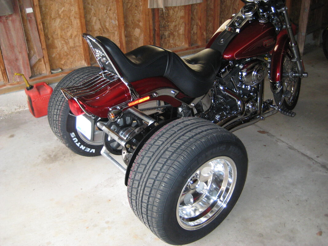

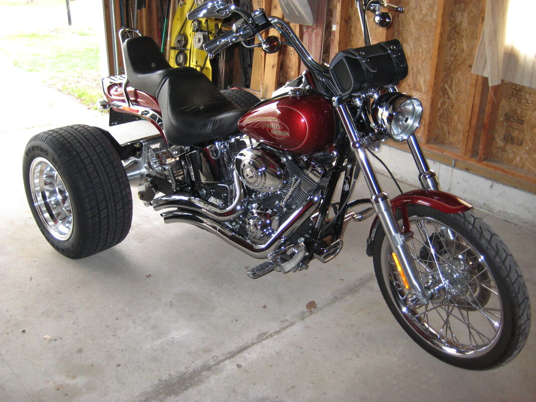

The Frankenstein kit is here, I took fender to body shop for painting they will not be done tomorrow but we will have the rest of it done by tomorrow. And I'll be ridding it tomorrow. I have taken some picture of the build along the the when I have some more I'll post them here to get the swing are bolt loose had to remove one pipe and that took 2 hours ( you would have to have been there to see why)
We are ready to put the rear axle in now. But we are stopping for the night both of us need to be somewhere tonight. We'll finish in the morning I'm hoping :pepper:
Very sharp! Better hang on tight it's red and we know what that means..it's faster ;) Can you stop grinning while riding? I still can't.:D
NO, I can't get the grin off my face. It way more fun than I thought it would be. I was thinking I was going to wreck my motorcycle by converting it to a Trike. But no way this is a cool motorcycle to ride it's different than the 2 wheeler was but to me more fun.:pepper:
Well done Rob! Came together nice, I can't wait to see it when you've got the fenders on. Really like those big tires and the aggressive stance :cool:
Wow, red bikes must truly be fast. That install seemed very quick. Cool. Wonder if I could get them to make one for a Indian that I could install that quickly? Going to have to contact them now. A new option might have just opened since they are rather close.

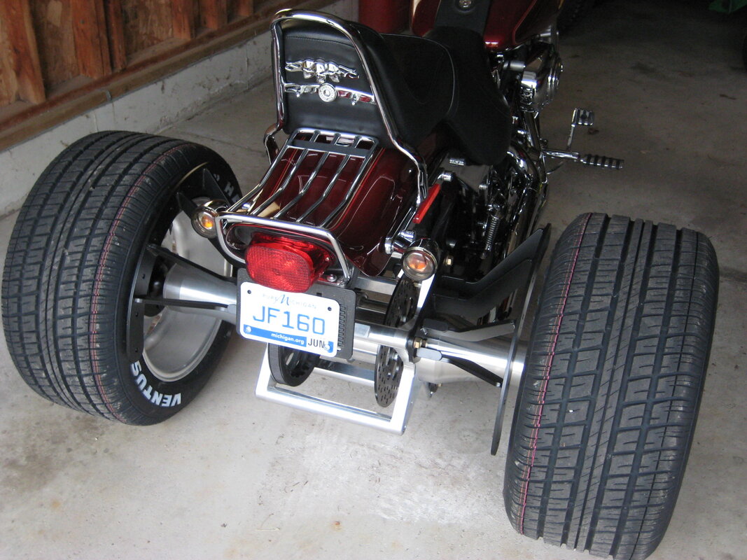

Is it black, could you be looking at the fender hangers? Or the brake rotor?
It must be fender hangers, you can really see it on right side in middle photo, did you make fender hangers, I dont have anything that wide on fender hanger that go on my trike . it is frankenstein manufacture,
