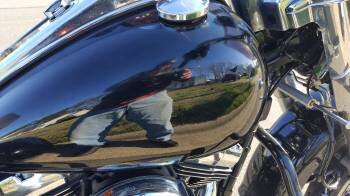

Did a search and got nothing. Want to remove emblem from tank on 2015 Free. Have heard it can be done with fishing line, but that there may be a couple small holes under it? Anyone done this and have info on holes or not? Thanks

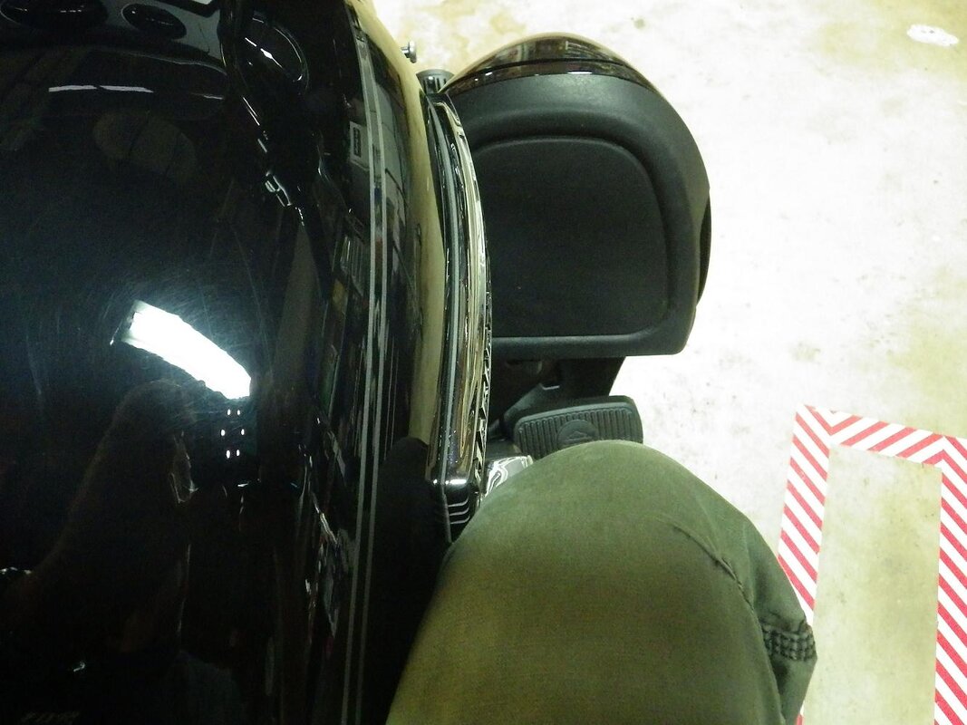

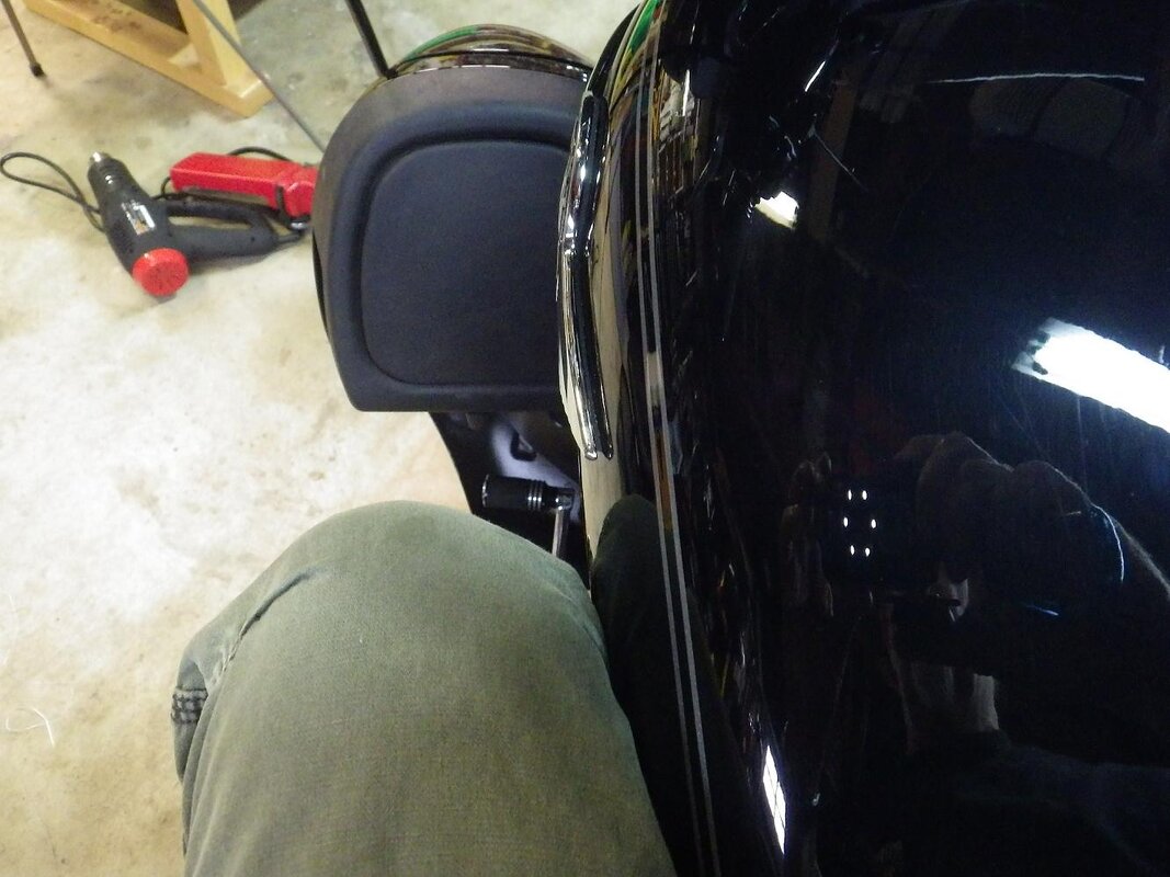

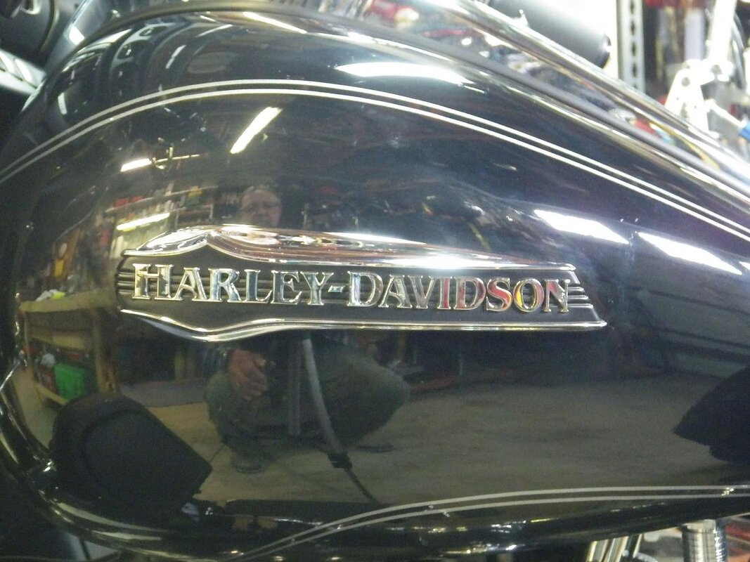

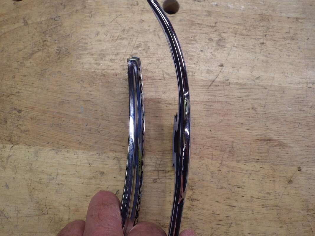

I have thought about removing the tank emblems because even though I have a Tall Boy seat my knees still rub up against the back corners of the stock tank emblems and on a long ride I ended up with bruising on the inside of my knees. While I was at a Harley dealership the other day they were unloading a new shipment of bikes, and one of them was a Fat Boy. I liked the emblems, and they sit farther forward on the tank so my knees would not hit them. I checked how much they were, and from Harley they are about $70.00 each. When I got home I went on to ebay and found these for $69.95 for the pair and these are chrome where the new Fat Boy emblems are a satin finish. I liked the chrome and the price much better so I ordered them.

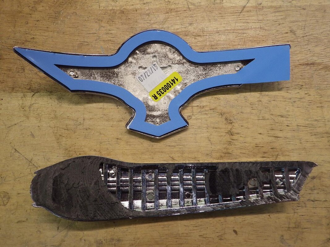

They came today so I set about removing the stock emblems using fishing line and Goof-Off plus Goo be Gone. The emblems came off fairly quickly, but the foam adhesive took a bit of coaxing using Goof-Off and a plastic spatula and a whole lot of elbow grease. I tried dental floss but it broke very quickly.
Now my knees are about 1" behind the rear of this new Fat Boy emblem :D
The stock emblems are much beefier and thicker, plus the adhesive backing covers the entire backside of the emblem.
I was worried that the more extreme curvature of this Fat Boy emblem might not fit this tank, as we have a 6 gallon tank and the Fat Boys only have a 5 gallon tank. But it fit and conformed to the tank just fine once I found the sweet spot.

Yup! There is a 1/4 inch wide slot that runs vertically from the top to the bottom of the tank so you can see how much gas you really have.
Of course I'm BS ing you. Harleys and others used to have blind holes to affix the emblems but that costs $$$ and so they have been sticking them on with two-sided sticky tape for years. I haven't pulled the emblems off my Free yet but I pulled them off my 2015 TK. No holes or observation slots.
