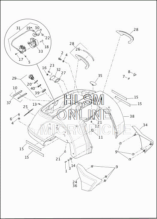

Here is a parts view for you
You've got 8 bolts to remove. Dont be surprised that the cheapo spot welded nuts on the frame extension snap off. Use lots of blue painter's tape all along the lower body especially around the mufflers.When removing body slide back slightly and tip up to clear the seat extension- use tape here. Gotta tip the front( toward rider) up at a 70 degree angle +- in order to clear the rolled over lower bottom body panels.I suspend the body with 4 ratcheting tie downs then just pushed the trike forward to clear the lower panels. Then lowered the body onto movers dollies. Of course I'm working alone. I think next time I'm gonna buy one of those HF 1 ton shop cranes and remove it that way. Did I mention use lots of blue painter's tape?
