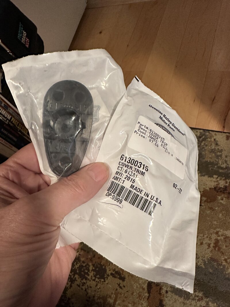

If you want to remove the docking hardware....
If you want to remove the docking hardware, these (HD Part no. 61300315) are available through your local stealership. I had to order mine, and it took a week.
If you just want to plug the hole in the quick-release docks, Rat's solution -- black rubber corks from Home Despot or Lowe's -- will getcha there. However, unless they've been been blocked, there are drain holes at the bottom of those quick-release docks, and the corks (or chrome-covered plugs) are just a nicety rather than a necessity.
