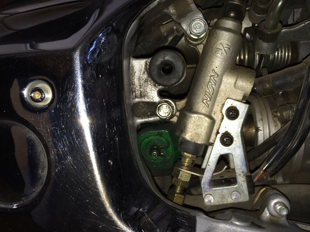

Just in case you did not know, MT says to lube the U-Joints every 6,000 miles. Since they seem to be the weak link in the chain it's probably a good idea to be slightly obsessive in that regard. On '06 and newer GL1800s the front joint, with Zert fitting on end of the joint, can be accessed behind the right engine side cover so you do not have to pull the drive shaft just to lub it. Here is a photo of what my '06 looked like.
See the green front couple U-Joint... :xszpv: :xszpv:

Just in case you did not know, MT says to lube the U-Joints every 6,000 miles. Since they seem to be the weak link in the chain it's probably a good idea to be slightly obsessive in that regard. On '06 and newer GL1800s the front joint, with Zert fitting on end of the joint, can be accessed behind the right engine side cover so you do not have to pull the drive shaft just to lub it. Here is a photo of what my '06 looked like. See the green front couple U-Joint... :xszpv: :xszpv:

That U-Joint is replaceable. If you look at the photo closely you can see the lock ring clip on the outside of the journal. With the U Joint removed I'll bet you will get things fixed fairly easily. :xszpv: :xszpv:
