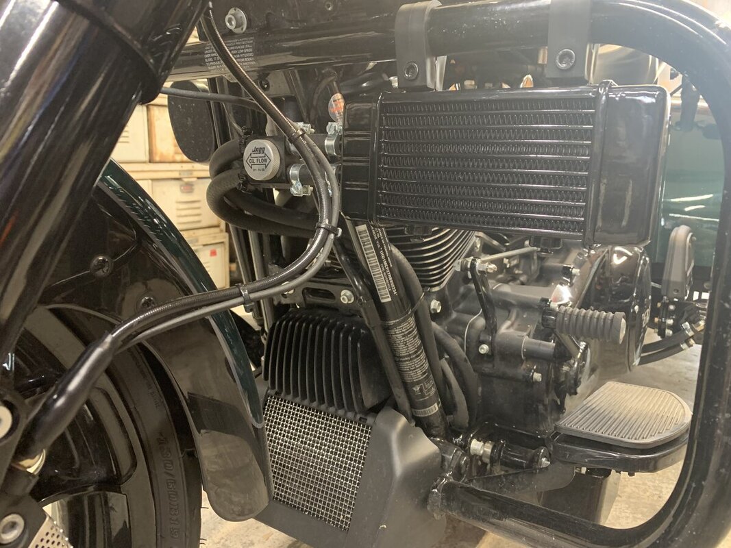

Sounds like you also solved your heating problems! The stuff I added
IMG_5247.jpeg are.........
2" DK tank lift
Filter relocation kit with the Flo filter. Same as your outlaw but I bought it from the folks who make it along with a spare filter. I also have a TC with the same filter. I wanted the brushed fins on the filter to match the cylinders
10 row Jagg cooler with bypass valve
