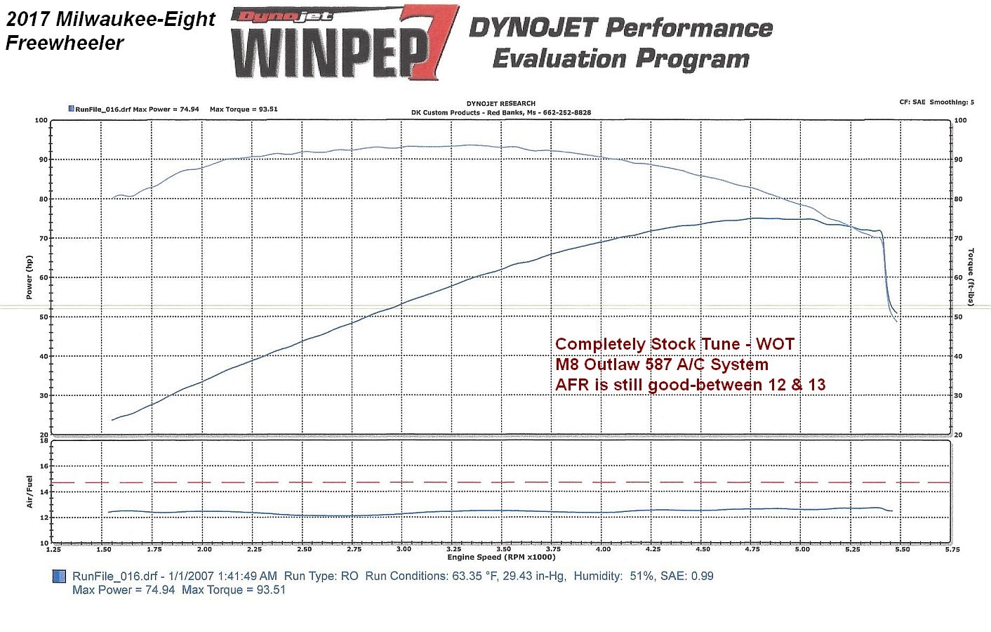

So for comparison the pulls were made with the same stock tune. But wouldn't the addition of a free flowing A/C require a tune to avoid a lean run condition? Not sure the ECM could compensate.
Unlike the Twin Cams, the M8's that we've tested do NOT run lean from the factory! :clapping:
That is not to say that the tune can't be optimized...but it is more timing than AFR changes, since HD got the AFR nailed pretty good stock.
All the dyno charts on the subject can be seen in this REPORT.
Here's just one chart to illustrate...look at the report to see all the info and charts.
Shows the AFR hovering between 12 & 13 WOT with the stock tune and the HiFlow 587. (a Twin Cam would be bouncing between 16 & 17, far too lean)
