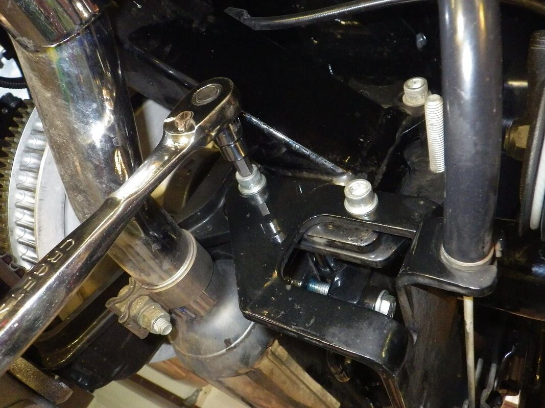

I went ahead and took off the right side shock bracket hoping when the axle dropped down it might free up the left side bolts. No such luck, so I will have to remove the parking brake bracket.

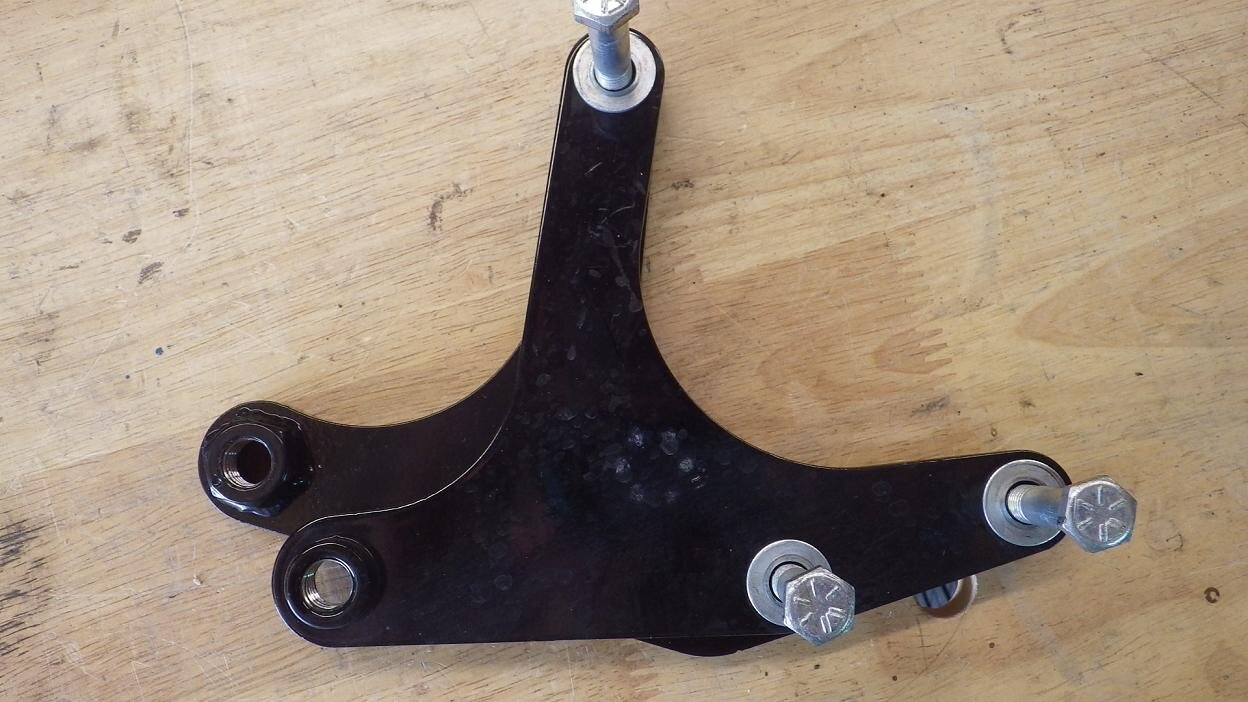

While I had the right bracket off I took a pic comparing the stock bracket (on top) to the DK bracket on the bottom.

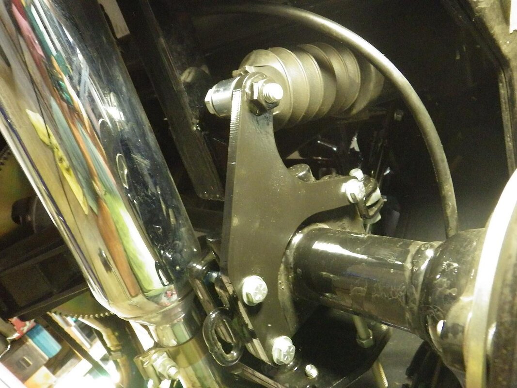

SUCCESS! :pepper:
I got both new brackets installed, and to be honest installation was a LOT easier than taking the old brackets off. Maybe it was a learning curve (and all of that Loctite Harley uses) but putting the new brackets on (with new Loctite) was a piece of cake.
Even though I read the instructions step by step a number of times, and before each step, I must have missed the part about having to remove the two (5/16") allen fasteners holding the parking brake bracket
:blush:
So whoever said real Men do not need to read instructions.....must not have been a real Man.
Thanks to everyone for your helpful suggestions, and Thank you Kevin for having patience with a newbie like me. Great product!!!!

Thanks guys. It was a challenge and an adventure, and I hope that others can learn from my mistakes.....and from my triumphs.
I was going to make an install thread, but I think this one will do just fine, and I am plum tuckered out to even ride her now. But it no longer scrapes the mufflers when I go up or down the driveway. :clapping:.

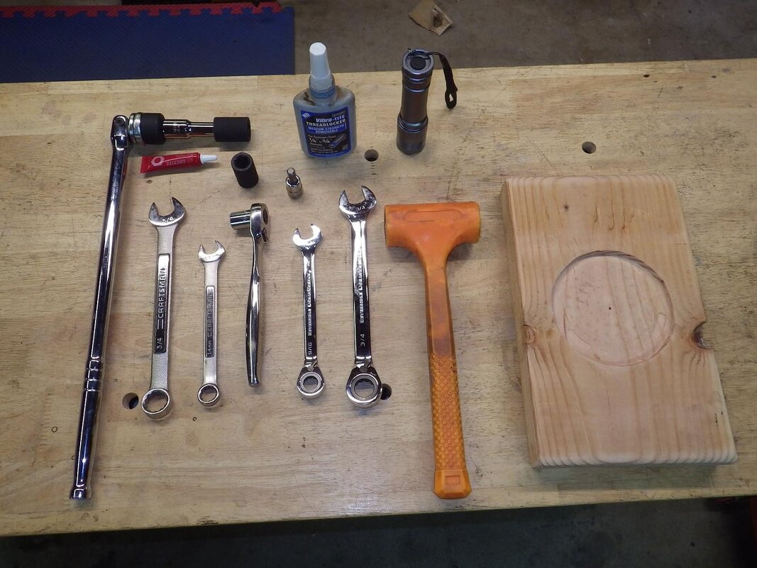

Here are the tools that I used......
a 3/4" combo Gear Wrench
a 3/4" non-ratcheting combo wrench
a 9/16" combo Gear Wrench
a 9/16" (14MM) non ratcheting combo wrench
a dead blow hammer on the 3/4" combo wrench to break the shock bolt loose
and on the 9/16" combo wrench to break the bracket bolts loose
a 1/2" drive 5/16" allen socket to remove and install the parking brake bracket
a 3/4" impact socket and 2" extension along with a Harbor Freight ratcheting breaker bar for the lug nuts.
a 9/16 impact socket and breaker bar for the upper bracket bolts
and a Harbor Freight 2-Ton floor jack with a wooden block pad
plus a flashlight and Red and Blue Loctite
Oh and my 2"x10"x18" bucket boards with eyelets, two 5 gallon buckets filled with sand, two dumb bells, a gallon of water and a gallon of some other crap to hold the front end down when jacking the rear end up, plus a Velcro strap on the front brake lever and a rubber chalk from HF for the front wheel.
